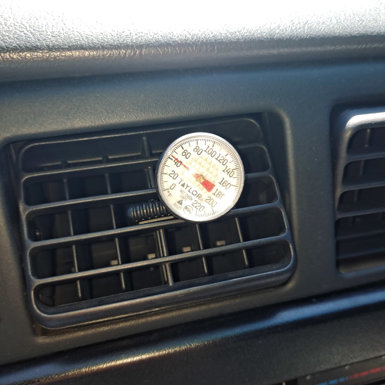

    What is your outside air temp when you’re getting 40 degrees at the vent? Is your air colder when you’re moving vs at idle? With my recirc set to outside air I get about a 40 degree differential at idle and around 50 when I’m moving. I’ve always wondered if this is the best it can do in Florida with temps typically low 90’s

    40 to 50 degrees sounds about right. In a humid environment like FL, your AC is putting a lot of energy into dehumidifying the cab, so you'd have to have the recirc on for quite a while before you'd see the temps drop much more than that. In dry climates (1997TacomaV6 is from Colorado), the recirc is just cooling the air, and it works quickly.
    Maybe you could check your filter, though. Never a bad idea with any AC unit. Could also try running a dehumidifier on the passenger floorboard for a drive or two to see if you notice a difference.

    Yesterday was 90 degrees,
    I hit 40 degrees when
    on the highway all day long , it's almost to cold, I noticed yesterday I had to move the cold vent
    to the hot section for a little bit.
    Idle is more like 48-50 degrees

    Humid doesn’t begin to describe the conditions here. Not sure what you mean by “checking the filter”, there is no cabin air filter in a 1st gen. But I have cleaned the fan and evap coil in the past few months and I’ve always wondered if this is the best the AC can do.

    Thanks for that info, this kinda confirms my suspicion that this is as good as it’s gonna get.

    Yup, it's a 20 plus year old truck not a Cadillac , 40-50 are excellent numbers with outside temperatures at 90-100 :)
