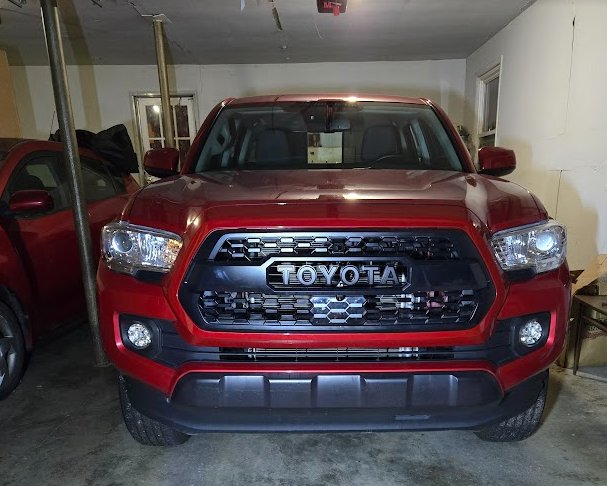

    Besides, I don't think it looks all that bad, I might remove it one day just to see what it would look like, but not if it affects aero enough to make it unstable when I want to stretch her legs...
