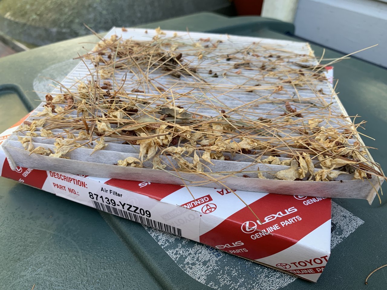

    Just took delivery of my new-to-me 2013 Tacoma. Swapping out all the filters etc. and the cabin air filter was the first one I did. Here was the old one. To say the least I was disgusted.

    I guess the previous owner wasn’t into maintenance.

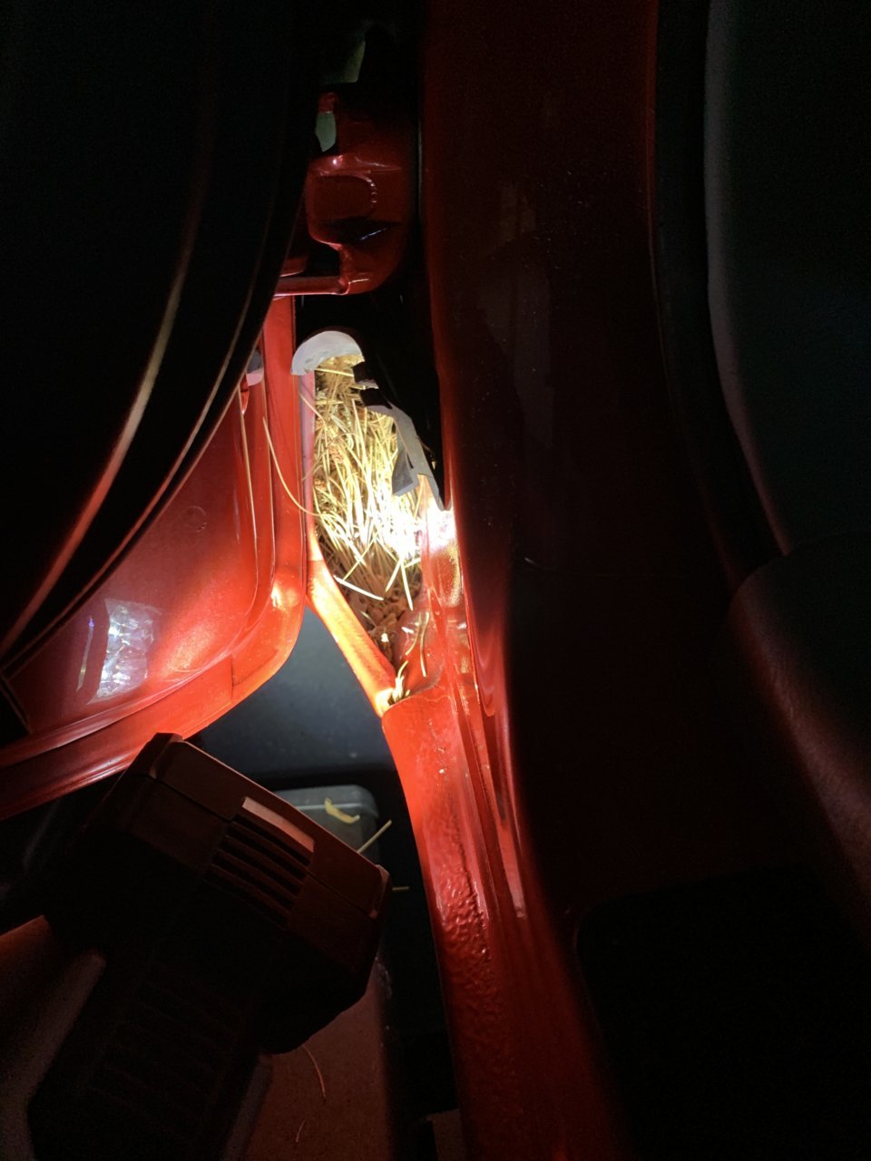

    check those 2 areas in each door jam below the hinge. Pull back the rubber boot and vacuum real good. They will be full also.

    My pillars were full on both sides. Wow.

    I will be taking care of all that. Let the fun begin!

    Usually when a cabin filter has been forgotten about it will be wet and scummy, the crap will be stuffed down in the ribs and packed in. That one is still fairly white, the leaves don't look old and moldy and they're just loosely sitting up on top.
    If you parked under the right tree for a month during autumn you get all those seeds/leaves in there pretty quick. Doesn't necessarily mean the last owner neglected his truck

    Thank you for a forensic analysis. I hadn’t given it that much thought but you’re spot on. The truck is in superb condition and I think a pine tree was the culprit.

    Maybe it's the photo, I see tree debris but not a lot of discoloration. :notsure:
    That shit can build real quick if you park under a pine.

    Yep, little bit of smoke but no fire. Just a cabin filter doing its job.

    my first thought was that the photo looks staged. I’ve never been able to remove one and have the crap on top sit there like that.

    Off topic a bit, but I do a decent amount of driving on dirt roads. I'm always shocked at how filthy the cabin filter is in comparison with the engine air filter- especially since the intake for the engine air filter is in the wheel well.

    Though the dealer should have cleaned it, I don't think that's necessarily really lack of maintenance on the owner. I have a lot of pine trees around my house. In the fall I used to take that much out almost weekly. I put a piece of window screen mesh over the opening above the air filter. Same with the front fender/door jam area, fills up easy and a pain to clean out.
