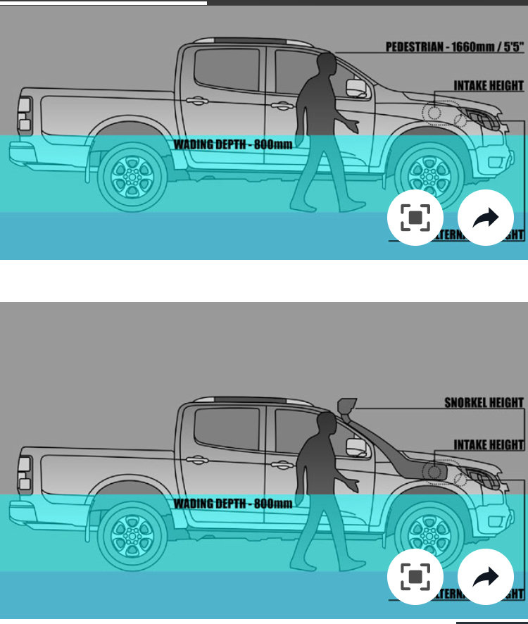

    I’ve never found this spec for a Taco, but as you can see, adding a snorkel does not change the recommended fording depth on an Isuzu D-max, because the intake height is not the problem. It’s other stuff under the hood:
