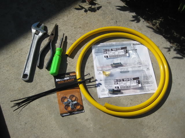

    When you get a few minutes, install the rear diff breather mod to keep safe in case of another water event. :thumbsup:

    What is this?

    It's got a cop motor, a 440-cubic-inch plant. It's got cop tires, cop suspension, cop shocks. It's a model made before catalytic converters so it'll run good on regular gas.
    Don't the breather tubes go up into the engine bay?

    Front does, rear does not. Unless the 3rd gens do something new that I don't know about.

    I did the diff breather mod on my FJC, 4Runner and Land Cruiser. I had the rear diff fluid changed after most water crossings and they saw no water before or after diff breather mod. So I know good preventative measure but not really sure I could tell a difference.
