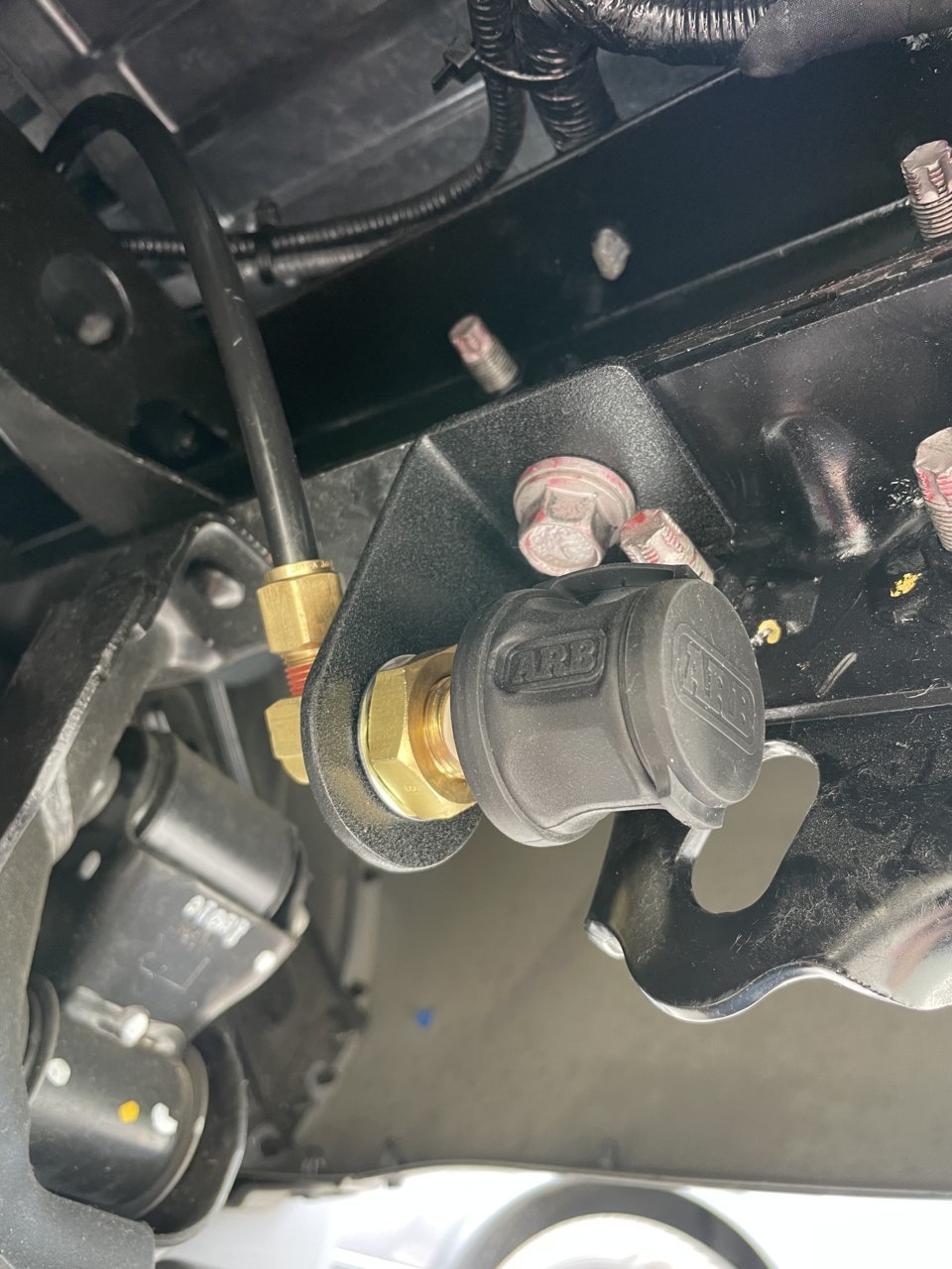

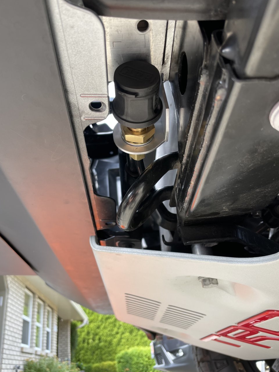

    In my truck I used DOT airline used for airbrakes along with push to connect fittings. Due to the heat created by compressing air you’ll wanna make sure that you’ve got 12” to 18” of stainless braided line coming out of your air compressor before you go into running your plastic lines. The airbrake line is a little more money over the poly (if I’m thinking of the same stuff) but worth it for heat and abrasion resistance.
    I ran my lines down the passenger side frame rail from under the hood and protected it with DEI heat shielding in the same spots that the factory lines were protected.
