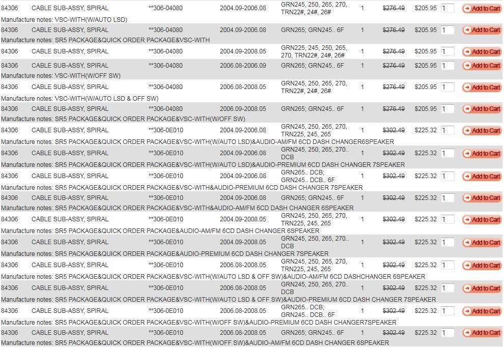

  19. Aug 8, 2011 at 7:58 AM
    #39
    fbconvert
    fbconvert Well-Known Member
    Apr 25, 2011
    #55535
    426
    Brian
    Seacoast, NH
    2005 Tacoma Double Cab TRD Sport
    You can order them here. I think it is something like $14 flat shipping last time I checked. As you can see there are several types of spiral cables depending on your truck model. You can put your vehicle Vin into their search and it should eliminate all of the ones that won't work with your truck. These are OEM Spiral cables...
    Edit: I just checked and unfortunately they do not ship to Canada. The prices crossed out are the typical prices you would pay at a dealership so you could probably pick one up for around $300. I would also suggest ebay. There is a seller on there from Canada that I have got a couple of airbags from and I am sure he would have a used spiral cable that you could pick up for cheap.
