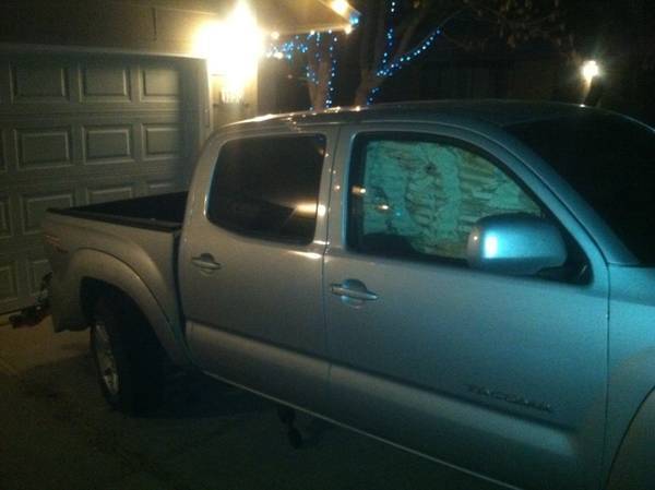

    Well I can speak from experience now. I was involved in a accident tonight and my airbag on the passenger side deployed. For anyone interested I replaced my airbags with like new ones from wrecked donor trucks. I sent my airbag computer to Myairbags.com to get flashed and everything functioned as it should despite the fact that I had a airbag warning light come on for a while and then turn off (I assume it is from the clock spring which had nothing to do with the first accident). I still plan to send my clock spring in to get fixed but now I will have to replace the passenger side airbag and re-flash the computer :mad:.
