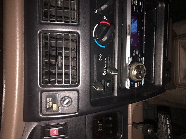

    Not sure why pictures I save upright always upload sideways :facepalm:Anyway, the switch has gone out. I turned it off 5 days ago and the airbag light does not stay on after cranking it up. It's been discontinued 69006-35011 - Thanks to everyone who provided input.
