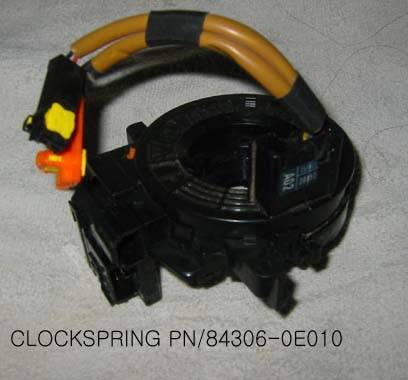

    It could be anything. From a bad airbag to a bad seatbelt buckle. Most likely it's the airbag coil, some on here call it a clockspring, it's the thing in your steering column that lets the steering wheel spin and have your airbag, horn & steering wheel controls work. I've seen numerous threads on here about that part going bad.

    Ok, I've read the forum and seen write ups on the ribbon assembly inside the steering wheel.
    The Ford Ranger has the same set up for the horn and whatever, but it does not trigger the airbag light; and I've resoldered that stupid ribbon in the past.
    I will hate to take apart the steering wheel of the Tacoma just to check that ribbon, anyone knows of easier way check it out?
    My Tacoma horn and cruise seemed to work fine.
    The truck was involved in light rollover but the airbag light was OFF then, light only came on a couple months ago so I am thinking that some sensor went out.

    so I took the steering wheel apart and removed the springclock for inspection.
    Physically looks good and clean, so I did a continuity test fom end to end.
    found 2 pins that seemed to be shorted out and 2 others that are showing nothing??
    Took the assembly apart, cable was dusty, there was a couple tears in the middle of the cable with breaks in the insulation + copper, also 2 lines are shorted out somewhere.
    Now I need to replace this assembly as there is no way to repair this ribbon.
    anyone has one laying around?? I am shopping for one.

    Not too difficult on the 2007,
    BE SURE TO DISCONNECT BATTERY. would be a bad day if airbag blows on you.:mad:
    pay attention to wires connections, also may need a wheel puller.
