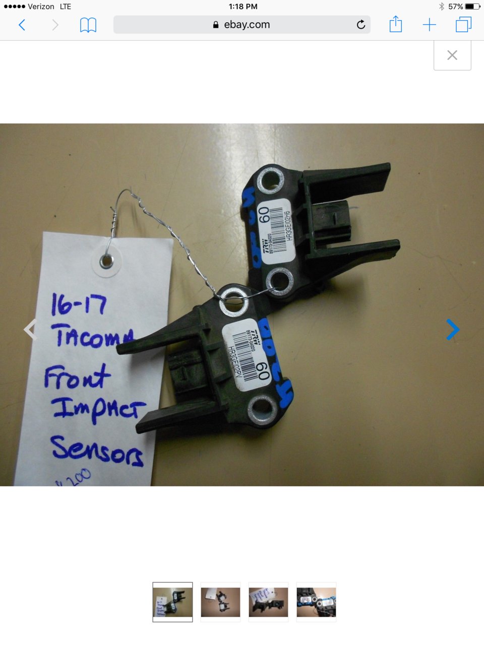

    Any luck with this? My truck is at the dealer now figuring out the issue. They've replaced the crash sensor with no luck.

    Looks like they replaced the air bag sensor. The light hasn’t gone on since. But it’s been warmer here. I’ll keep you posted
