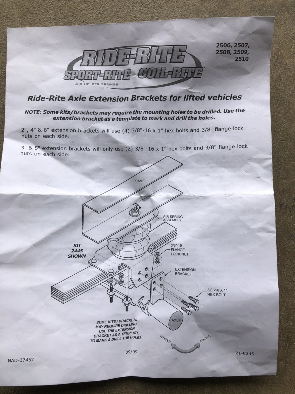

    Here is the part you need if you have a thicker leafpack otherwise part of the airbag mount will not be resting on the axle as needed:3B7AD4D8-764A-41F2-A5A3-DF849D190700.jpg
    It’s the extension brackets shown in this image.

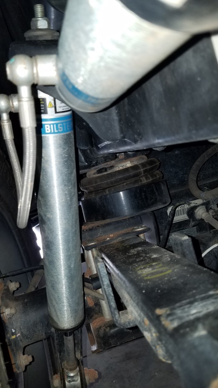

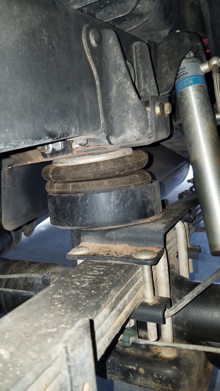

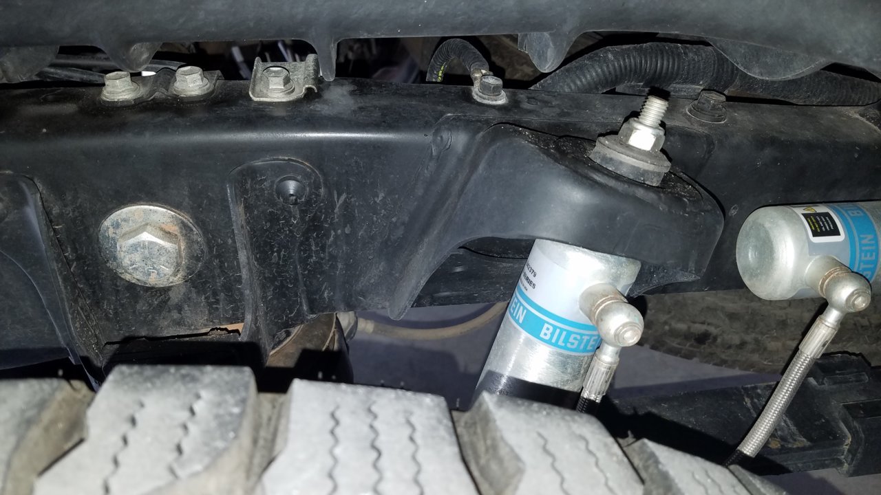

    I have 5160s, firestone bags, and cradles currently. Stock leafs)
    Works fine but the cradles with firestone bags excessively limit up travel unless you are lifted. Going to remove cradles for now when I get around to it.
    I love the remote wifi airlift controller. No more cranking trailers up and down for me...

    I just snapped a couple of pics. Note this is with a wheel center to fender flare of about 21.4"
    I didnt take any without wheels20200318_170924.jpg 20200318_170948.jpg 20200318_171111.jpg 20200318_171151.jpg

    Awesome. Thanks. I am 2" lifted in the back, so I purchased the 2" extender. Seems pretty straight forward

    I believe so, fit it to the air tips you get.
