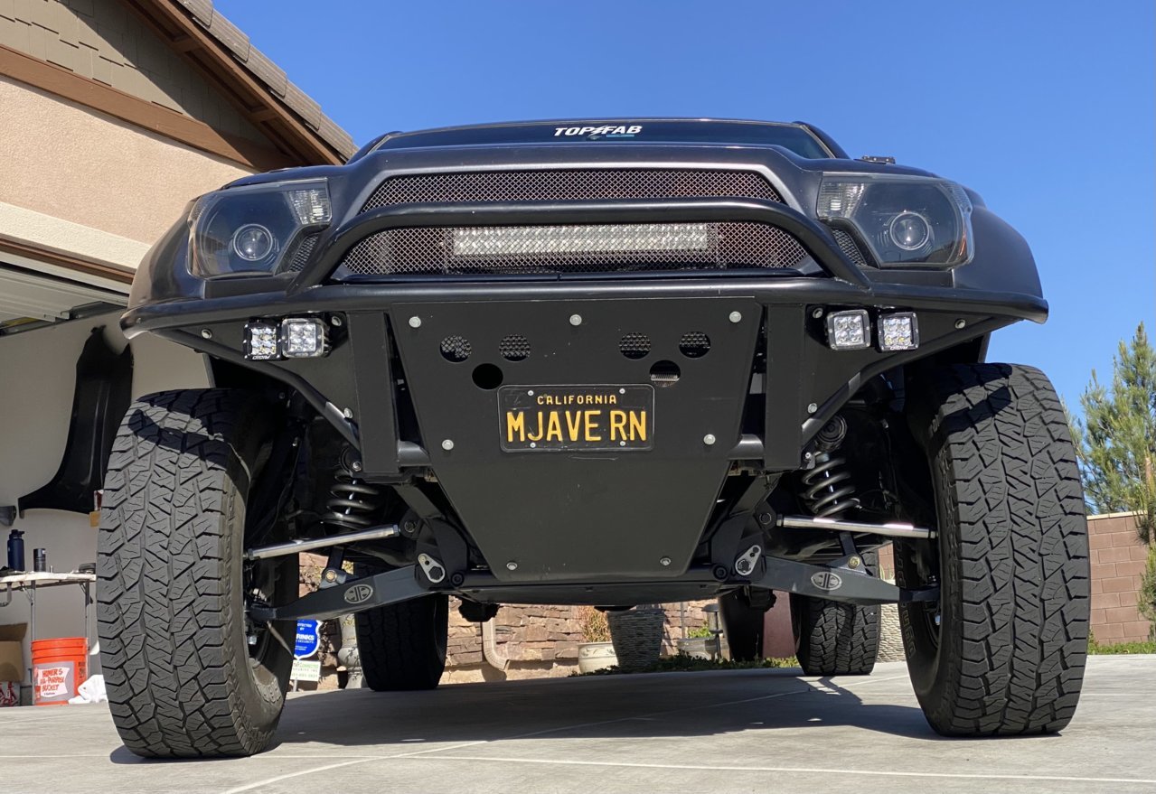

    New bumper , new look
    Traded my plate bumper for this one.

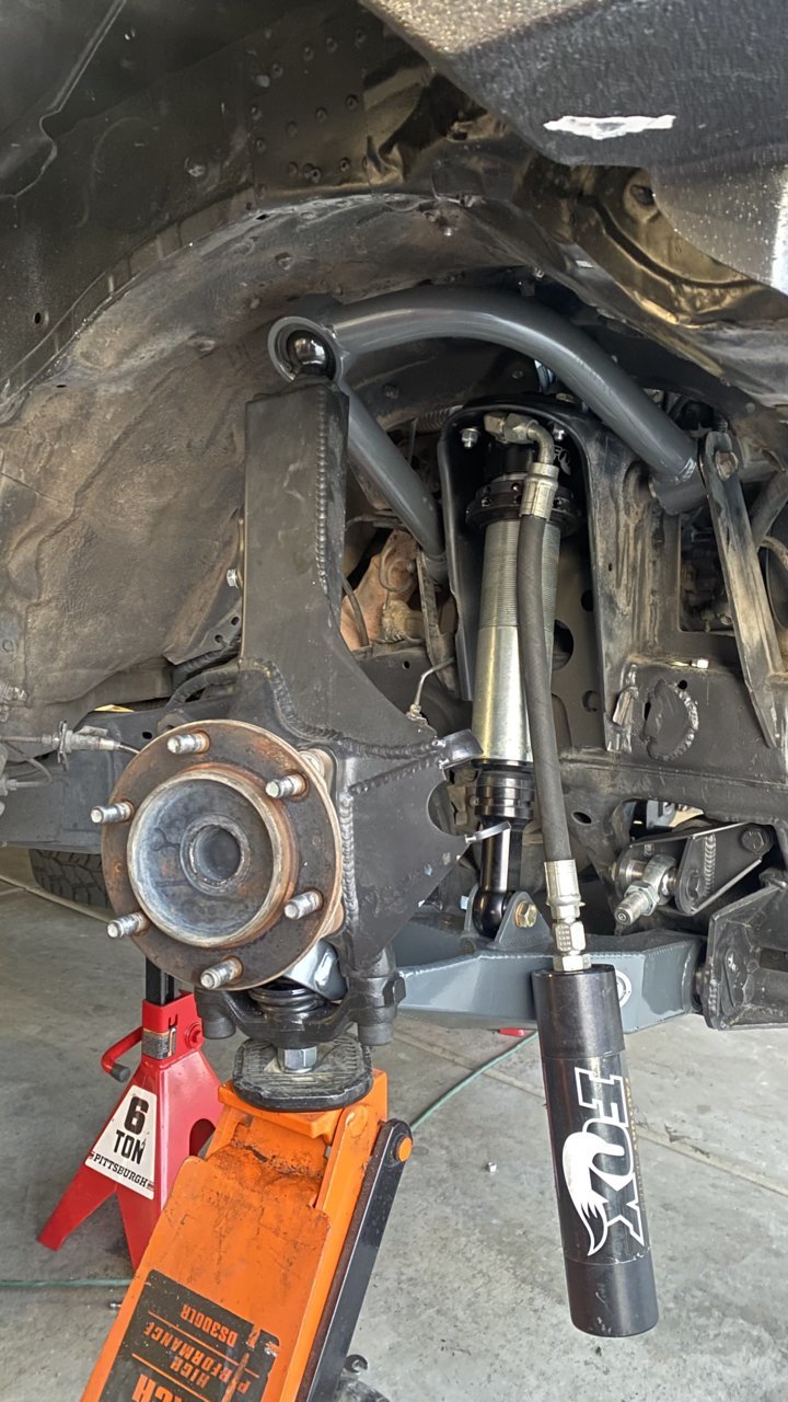

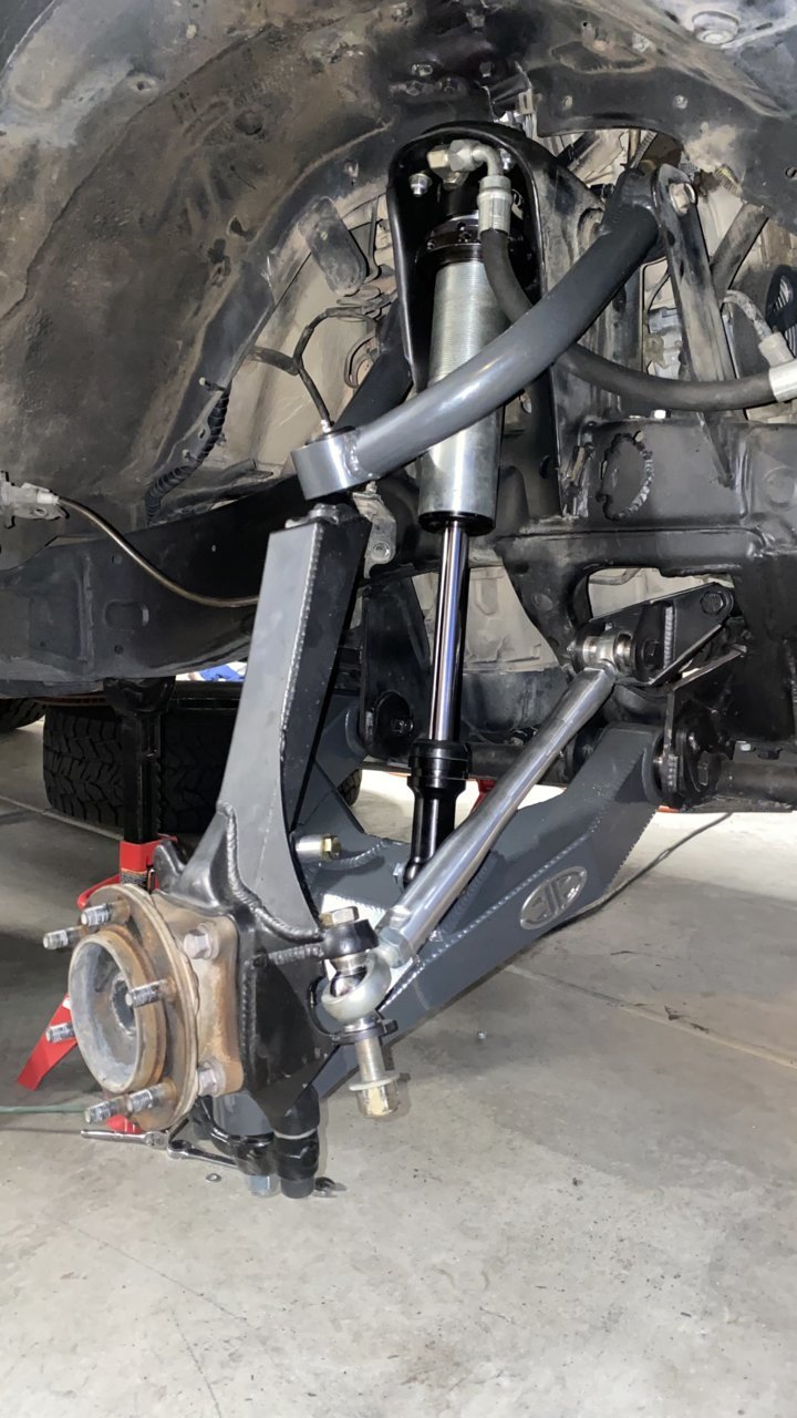

    LT kit is installed. Fox shocks are temporary until my King coilovers and bypasses are delivered. I just did a rebuild on them and they’ll be up for sale when the Kings arrive. Will be bumping and strapping it this coming weekend. JDFab killed it with this kit, it’s the final piece for my front that includes their LCA tab pivot kit, spindle gusset/double shear steering knuckle kit and slide rack. All 4 of these make for an almost bulletproof front end.
    B621513E-7D92-47AA-BFB1-04A69694983B.jpg BD54F5A5-C4F9-44D7-87E7-4BD286FD7BA5.jpg C82B8F31-0470-43C9-8611-754533561146.jpg D5CB279B-4879-4AB5-AB61-EFCE757EA569.jpg

    Looks like shit

    did you order freebleeds with the coilovers? looking better but it's missing front shock hoops and gussetted shock towers.
