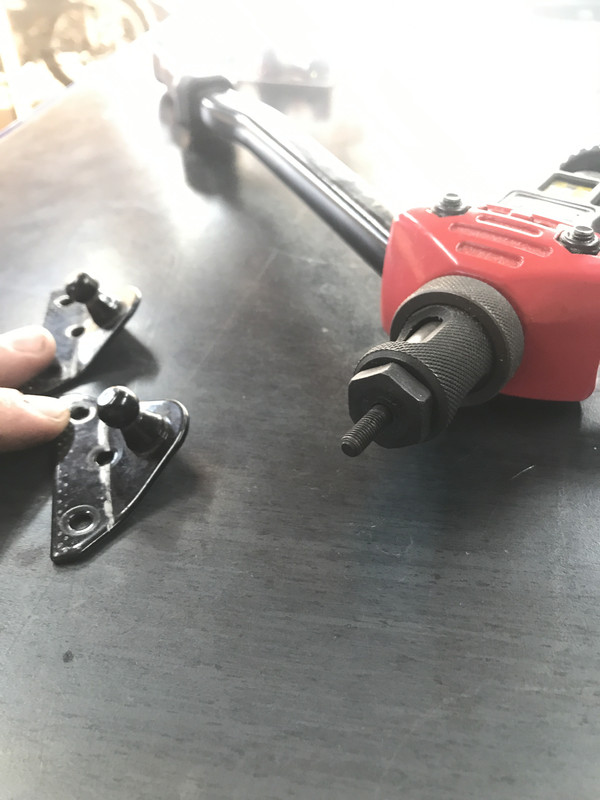

    Installed the door hold open fix thing from @plasticauto on ebay. If you recall I'd tried to fix this exact part by plastic welding in more material which worked but eventually wore down as well. This kit replaces the plastic pieces that interface with the composite sliding rod thing. Works great even though my detents on the sliding rod are worn down some.
    The kit contents
    The force required before
    The part you have to take apart
    The pieces that wear down and you replace with this kit
    The force required to start closing after

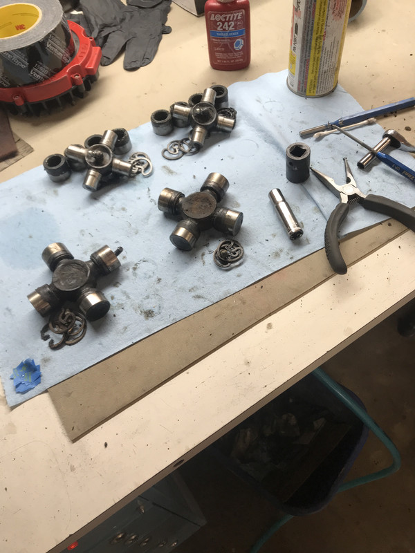

    Uh yeah, put in new U-Joints. All 5 of them. I only wanted to replace the center carrier bearing but well you know how that goes.
    Spicer everywhere. Make sure for the rear to get the spicers with the zerks on the end caps.. pn 5-1330-1x if you're lazy and the ball/u-joint tool that you can get on loan from the autoparts store is the tits for doing this. No banging, no tryna wrestle with it in the vise.
    New and pretty. Put a coat of enamel on it too cause, shiny?
    The rear has zerks on the end cap, not out the middle spider thing. Also.. for you OCD type :cough: line up all the zerks so they're in the same clock position.

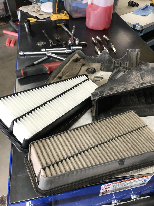

    Replaced the spark plugs with denso K20HR-U11. Ran fine but old ones seem a bit worn out. I hadn't done them since I had the truck ~50-60k so who knows. Gap was about 2x what it should have been with the electrode and center ground worn quite a bit. All were about even though so I take that as a good sign. While there, did the air filter, which I do semi regularly. ( a fella could put this on a calendar or something but aint got time for that. I can barely update the internets with all the cool mods afterall )
    This guide is good for this job. https://www.tacomaworld.com/threads/how-to-spark-plug-change-1-gr-fe.30479/
    Old plugs. Kinda gunked in on the treads. Dunno if someone used grease to put these in with and that's cooked grease or what the heck.
    Old vs new. So far after 2 tanks, old plugs and old filter got 2mpg more. Eh. 19.4 vs 17.7

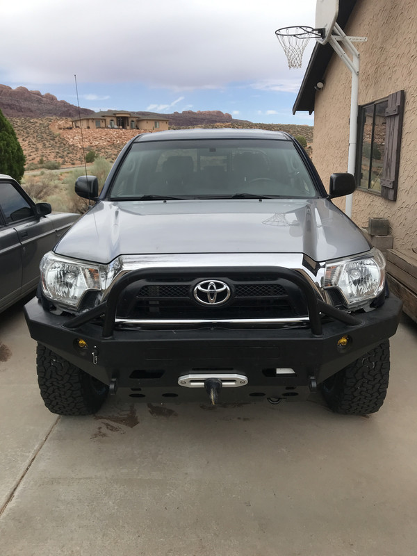

    Started my 2.0 to 2.5 front end swap
    Got a good deal on these scratched up OEM headlights
    So I sanded them down (cycle enthusiasts might get the "sandra" bucket joke)
    After sanding to 1200
    Built a paint booth in the garage
    Turned out pretty good... the second time. First time I had contaminates that gave me little fisheyes I think they're called so I sanded back down and re-did it.
    I'm doing the painting myself and I'm a total noob... er I mean I'm 100% pro since I watch The Gunman on YT. To practice, I decided to paint the 2.0 hood. It was badly sun damaged but otherwise in good shape.
    Took it down to bare
    etched and primed
    Base and clear
    2000 grit and polish. Honestly I'm not sure if that made much of a difference. Looked good before and good after. Eh. I needed the spa time at 100 degrees inside the paint tent working the polisher.
    Started the swap
    Parts labeled what's what. It gets a little confusing at least for simpletons like me who were trying to have every part required before starting this project
    *** distraction ***

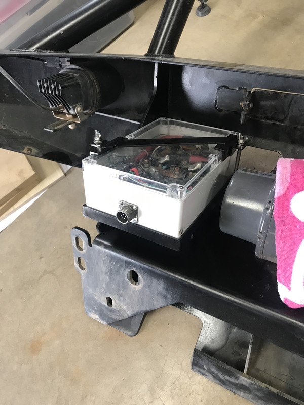

    With the bumper off, I spy a good spot to mount my winch controller. I put the relays in a waterproof box and made an extension cable for the controller plug. This was a bit of a sub-project... Before you go an say... dang I wish I had the tools to do this... um, i was cross legged on the garage floor stick welding this.. so nothing fancy here.
    *** end distraction ***
    I should say during this facelift process I ended up deadlifting this friggin Pelfrey Built bumper about 1000 times. (accurate number, I'm much sure about)
    And getting closer
    Time for another sub-project. Er, scratch that, it's not a sub of the facelift at all. Totally unrelated.
    Torn CV boot. So time to reboot them. Ordered the OE reboot kits.
    And "while I'm there already" *freak* myswell do the needle bearing to bushing thing.
    Really not that bad of a mess all things considering. I've had CV messes be FAR worse.
    Now I need to figure a way to attach the lower part of the new grill. Got some idea from forum members here on how it attached when running OE bumper so that's a good start.
    Then I need to paint the fillers that go below the headlights. They're plastic so I had to get different primer and now it's monsoon season and I'm without an air dryer so I'm waiting on painting more.
    I think I'll wait till after all the pieces are painted and it's mostly back together... but I need to decide if the bumper is going to take more customizing to fit/flow with the 2.5 front end. It's a Pelfrey bumper and IIRC the 2.5 bumpers had little triangle flip up bits whereas the 2.0 versions are just flat all the way across.
    So far all I've done to make it fit, was trim about 1" off the backside of the main flat surface part since the 2.5 stuff sticks out forward of the truck just a little bit more than the 2.0

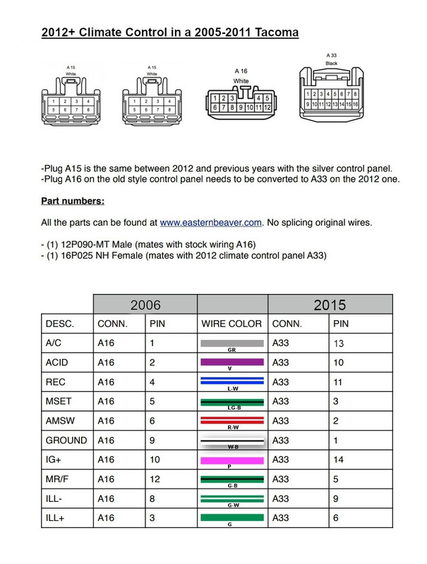

    So I have a new aftermarket radio to install, but, it comes with a black surround and well that would clash with silver climate controls. I thought I was unique and clever in noticing that the climate controls from the 2015 that I bought my hood from were black and looked about the same size but nope, someone of course has already figured this out. In any case I had purchased the 2015 climate controls and the pigtail and even tried to source the connectors before I found the thread on TW where this has already been done.
    I ordered the connectors from easternbeaver which came actually pretty quickly and made up an adapter harness today. I bought enough components to build up 2 extra so I'll post those up for sale if anybody wants. The only odd thing I noticed is that some of the directions on that thread showed pin 16 being used on the 2012+ climate control and that is not accurate from my research in wiring diagrams and from comparing the OEM pigtail.
    First, updated the from---to pinout guide after validating it against wiring diagrams
    Sanity check with the OEM 2015 plug. If you're ??? it's reversed. The paper is showing looking from the front of the connector. So looking at the picture, pin 16 on the connector is bottom left, while on the paper is bottom right.
    All the kit prepped.
    Lucked out I had a molex crimper that worked pretty darn good. If you're thinking, "oh I can just make due with pliers or solder it" for-get-about-it. On the 2012+ side these are pretty small pins and you can't d*ck them up or they won't fit into the connector
    All the wires set. There's no assembly instructions for these sumitomo connectors but after staring at them long enough I arrived that the larger pins for the gen 2.0 clip in only one way and the gen 2.5 tiny pins have a small wing on one corner of the square pin that mates with a grove in the connector.
    Trial run. All good. All the things come on, fan speeds work, vent control work. Hate to say it "worked first try". Jinx
    So taped it up with that fancy cloth wire tape stuff
    Tucked in the OE connector and both connections are about equal length then
    And... old
    New... which will obviously look more in home once the rest of the plastics in that general area are black as well.

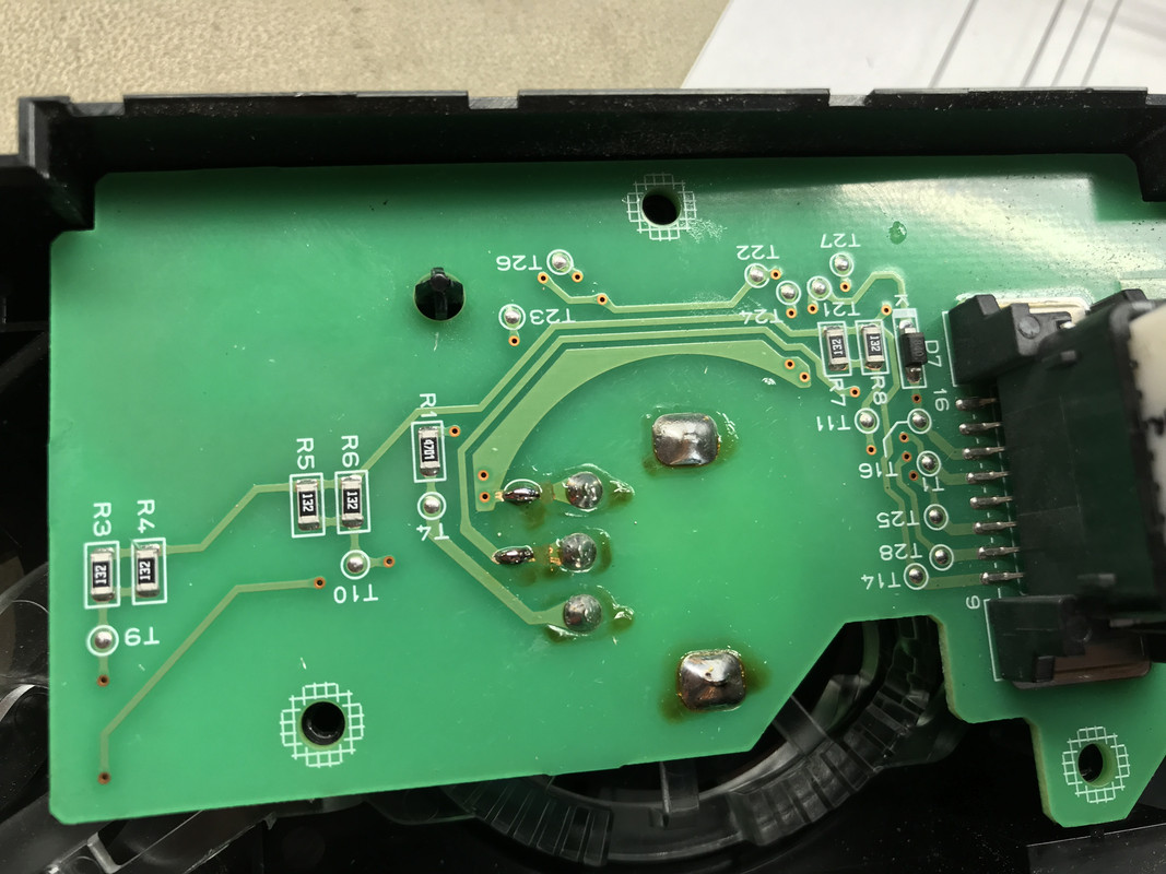

    Getting back to my 2.5 gen black HVAC panel. I found that my hot and cold were reversed. So when the dial was in the cold position, hot air was coming out, and when rotated to the hot position cold air was coming out. At first I thought I messed up my wiring so I double, triple and quadruple checked it. Next I measured the ohm reading between pin 6 and 9 on my adapter harness, which is between ground and AMSW. On my 2006 dial the cold position was highest ohm ~9.3k going and dropping to ~4.7k at full hot however on the 2015 panel, this was reversed, with cold being ~4.7k and at hot being ~9.5k. Hmm.
    Learned my lesson before, so did a quick google and tacomaworld confirmed my suspicions and I found @db2 great post here 24 .
    I followed these directions and tested and sure enough that fixed it. If your intimidated by this, I wouldn't worry too much. Cutting the traces and flip-flopping these two is way easier than making the adapter cable with those tiny pins and the A33 connector.
    Instead of doing the trace criss cross you may also be able to swap in the 2006 potentiometer to the gen 2.5 PCB as @fbconvert notes in their post here
    If you're taking the HVAC panel apart, you gotta take off the fan speed backing to access a hidden screw
    With fat trace up
    Cut the traces and test that it's fully severed. I used a dremel with a small bit to cut through the trace
    Severed and scraped clean
    Fluxed and tinned with solder. Tinning just means putting a little solder in place first, before you attach the wire. It makes it much easier to attach the wire when it comes time and reduces the amount of time you have to hold the solder pencil to the part
    Did the old criss cross here.
    Closer up
    And after testing, re-taped my adapter cable. It was fine the whole time but hey, super duper sure now :thumbsup:

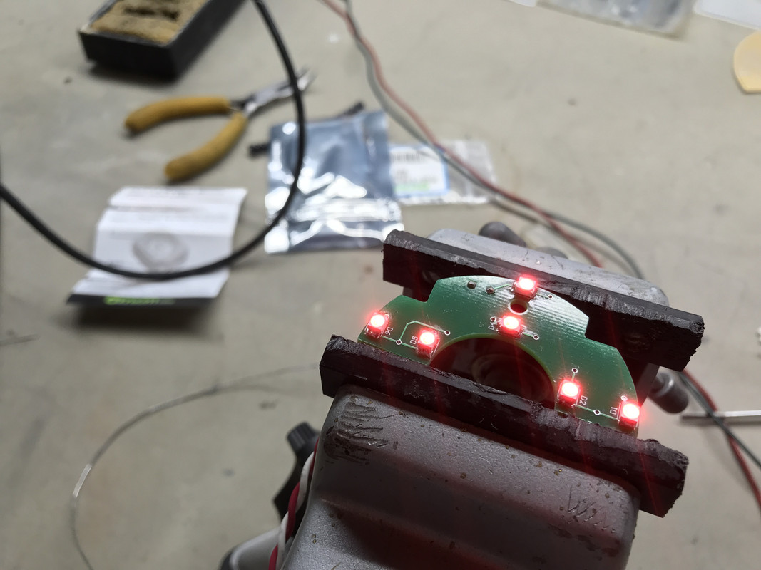

    Course I had to change out the amber for red LEDs. No prob, I got hooked up with the right ones to order and soldered those lil bìtches right on.
    While in the dash, I found this mofo. WTF peeps? When you remove an alarm sys, would you kindly take your crāp with you?
    Anywhooooo, to tap into the illumination wires... the harness from the switch doesn't point in the right direction so my OCD had me follow the loom up to the main loom on the dash bar, and over to the instrument cluster. Curiously G and G-W are not the correct wires at that connector, there you need G and B-W. No problem. Got that all sorted
    And here's the onoff porn you all came here for. (don't pretend not to know what i'm talking about)
    Before
    After

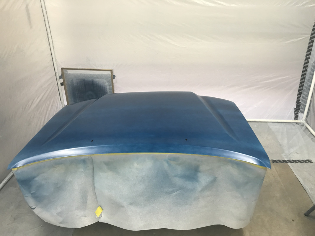

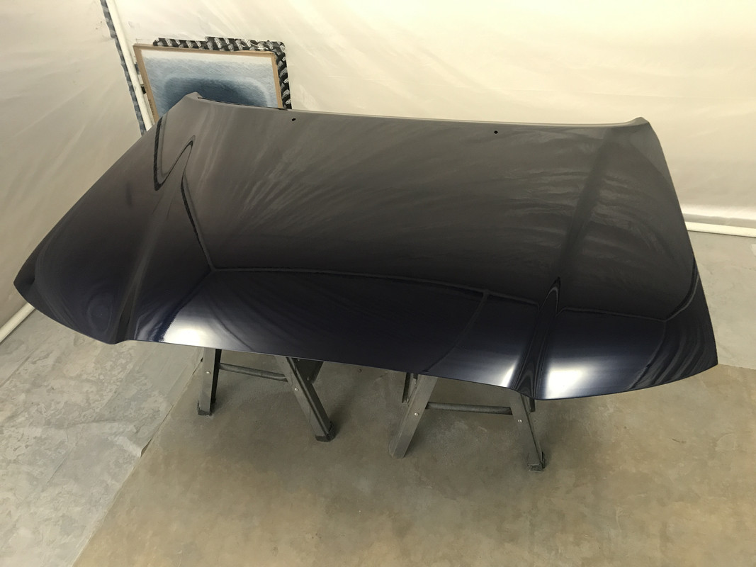

    Painted my 2015 hood.
    I'll skip the part where I think I didn't wait long enough after base before spraying clear and the paint boiled on me and I had to resand it all down and start over.... :mad:
    So I guess that's it for the front end conversion.

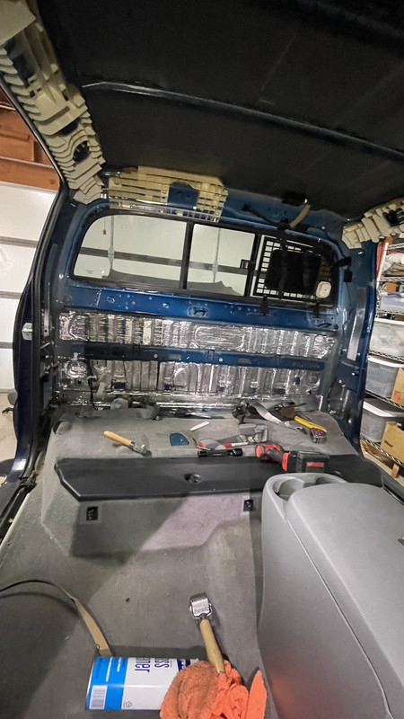

    Installed some sound deadening material. I used Noico Red 150mil foam and Noico 80mil butyl. Focused on the rear of the cab, the roof and the outer skin of the doors. I used a little over a box of each material.

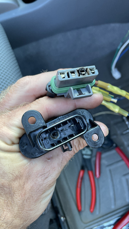

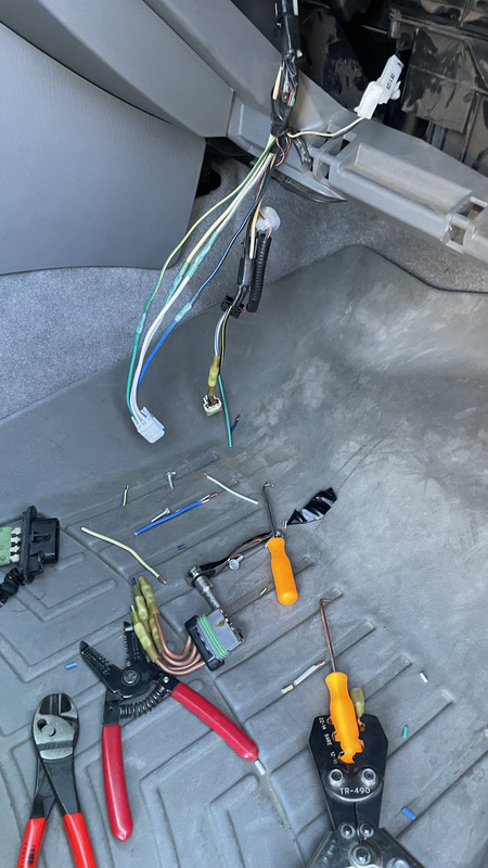

    HVAC fan started working only on high again. Already milked this thing along for a number of years now, futzing with the fan motor, wiring, connectors, ebay/Amazon fan resistor so just went ahead and got a new OEM fan motor, resistor and resistor pigtail. New connector is different with different colored wires so found this post pretty helpful showing the wire diagrams from old and new. Pretty straight forward from there.
    Still tested it before committing to crimps
    Crimped and shrunk
    This was the ebay/amazon resistor that lasted oh a year or two?
    re-wrapped with cloth loom tape and back installed. Purrs in all speeds now.
