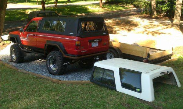

    After contemplating converting the Taco to 4x4 with a SAS, I decided to keep it reliable for now and buy something I can beat on a little without worry. I picked up this 85 4runner. My progress is slow but I will update as often as I can work on it. My plans are to make it as beefy and capable as I can while keeping the body mostly stock.
    The p/o claimed some work has been done to it. It was originally an automatic, a 5 speed was swapped in with a new clutch. The 22RE's head gasket and timing chain were replaced. Oil was leaking out of the valve cover and I could see someone installed a new gasket set but the bolts were just past finger tight, so I tightened those down well and alas no more oil leaks. It runs well for a 240k mile engine. The Mickey Thompson MTZ's came with and only had a couple thousands miles on them.

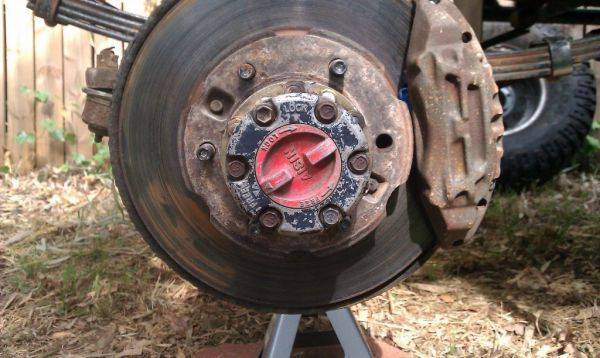

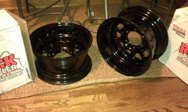

    Well the sister called me up today to help move furniture so I didn't get much done. I inspected the wheel stud situation and most of the front studs look fine, there is just one missing on the driver side and a damaged one on the passenger side so I will replace those 2 and call it good.
    I test fit the wheels but forgot to take a picture during the frustration of them not fitting. I should have done some more research but oh well. The inside of the wheel is hitting the outside curve of the caliper and the D-windows will hit the front of the caliper as well. I ordered some 1/4" spacers for the front and I will just grind away on the calipers to make 'em fit. They will work fine in the rear.

    Forgot to add, the P/O did a FJ vented disc swap. I don't know if a larger caliper was installed or if I still have the factory calipers, and if the Pro Crap wheels would work with the original setup. I know FJ-60 guys have trouble fitting these wheels. Either way, they are going to fit once I go pick up a grinder.

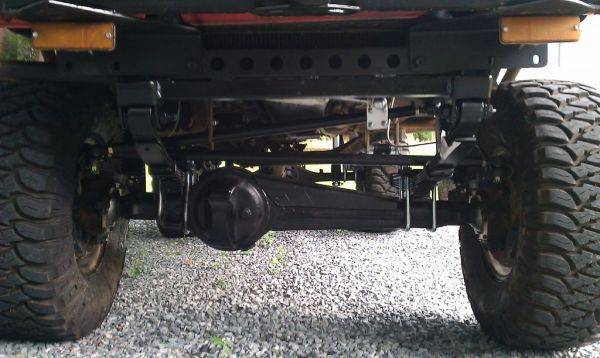

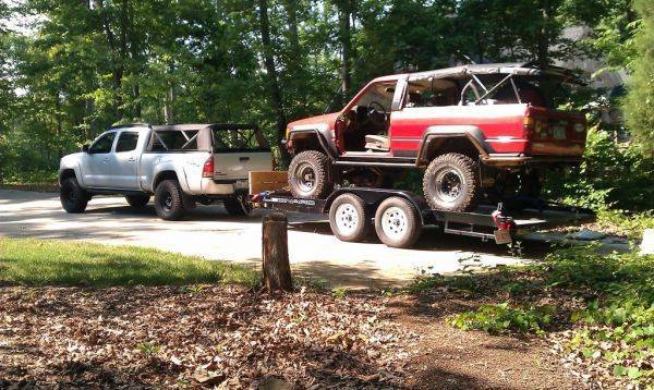

    Dropped it off at Carolina Truggies yesterday for the suspension work. They will start on it monday and I pick it up friday. I will post up some pics when I can, and if you like carolina truggies on facebook you will probly see it. I used to deliver pizzas with Josh, the salesman. Small world.

  12. Jun 18, 2012 at 5:22 PM

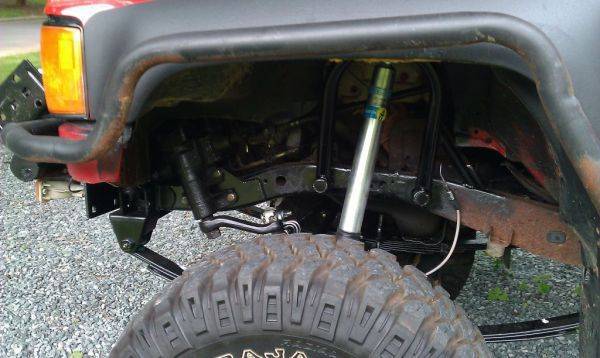

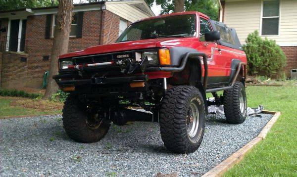

    Got the runner back today and I am very happy. I can't wait to get these springs broken in. I will probably remove leaves from the rear and maybe the front but I will wait and see how they settle. The steering is far better than the crap push-pull setup. One problem I have is the rear brakes. They are rusted pretty good and the bleeder bolts are seized, so I'm going to research some rear disc swaps.
    The All-Pro driveline e-brake works great, I'm glad I can park on a hill without worry now.

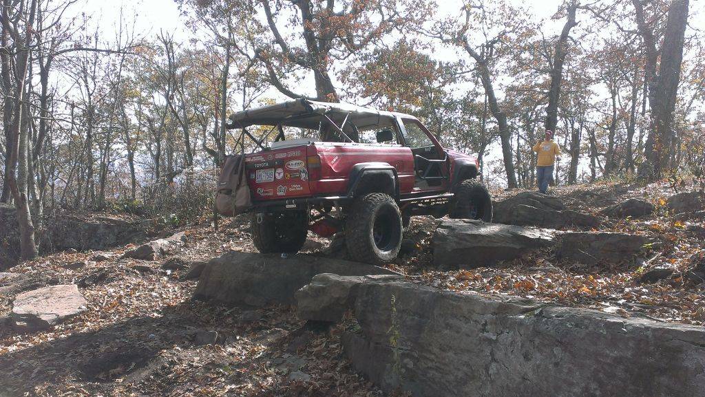

    Gettin' up there. Be real careful next time you're on some off camber stuff. Looks good though!

    Yes I will be. The front is flexing good already but the rear is pretty stiff. I will drive it for a while and see if they start settling.
