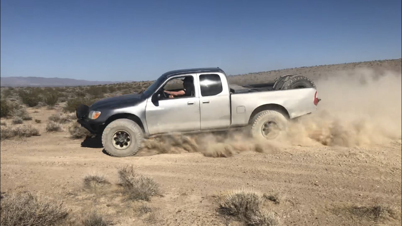

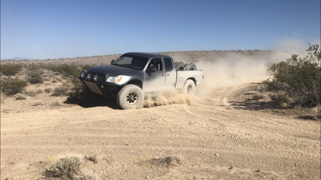

    Just another day in Pahrump...

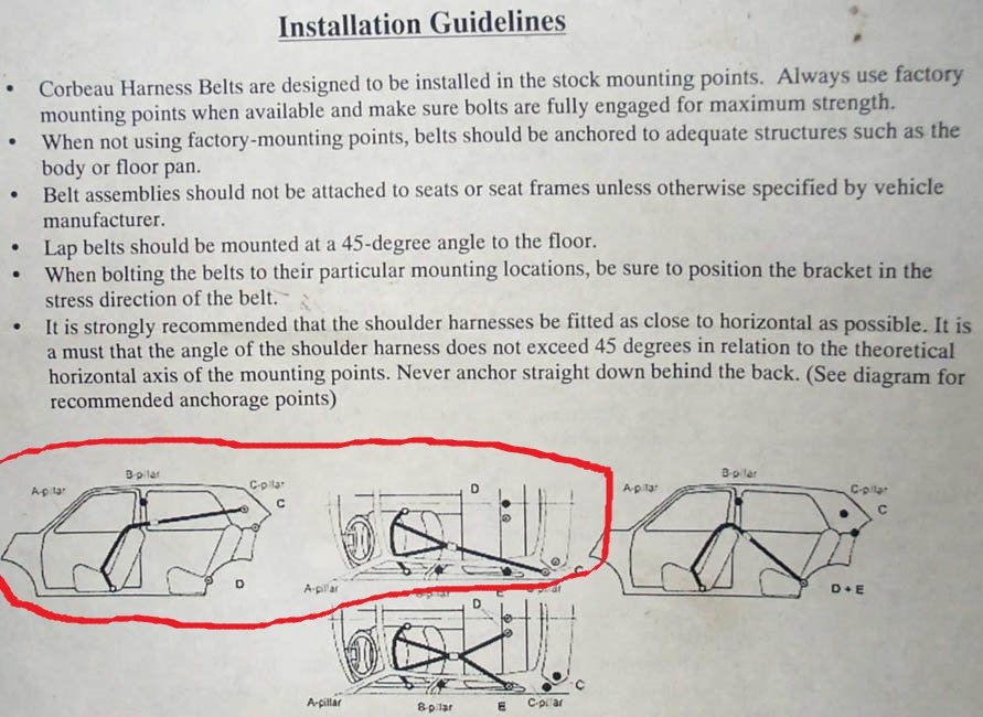

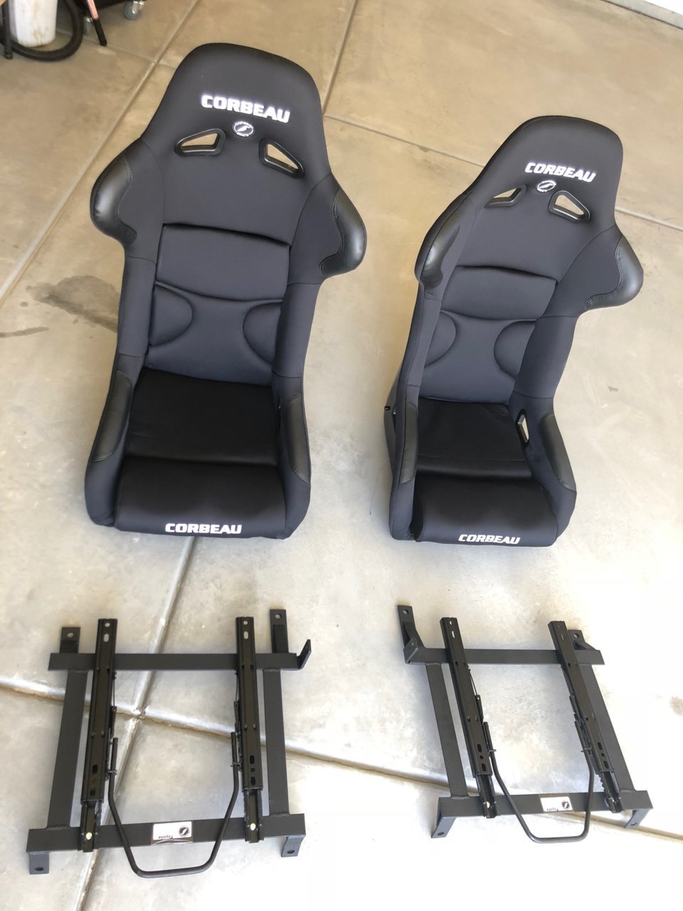

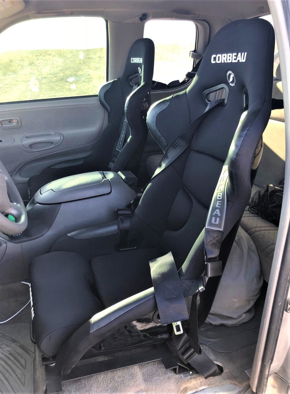

    Went ahead and replaced the stock front seats with some Corbeau fiberglass fixed backs. They make a bigger difference than I thought they would. I'm used to race seats on a race track, and they do offer support, but the benefit is not nearly as noticeable on a smooth racetrack as it is on dirt. I feel waaaay more connected to the truck now. Steering this thing through turns is razor sharp compared to the disconnected numbness on the stock seats. I can't emphasize enough what a difference these seats make in driving off road. Not to mention the added safety and back support these things have. Money well spent in my opinion.
    I went with Corbeau over Sparco and others for several reasons:
    1) they make a fiberglass fixed back seat in several sizes.
    2) they actually make a seat bracket for the 05 Tundra. Sparco does not.
    3) the seat bracket includes the sliders! Sparco does not.
    4) cost for the brackets, sliders and seats is half as much as the Sparco seats alone.
    5) Corbeau is proven (proven enough for my needs)
    6) I don't need anything FIA certified, although it would be nice, but damn that gets expensive.
    Here's the part numbers and cost from Solo Performance if anyone is interested:
    CBS-E2027T 1 Corbeau Seat Bracket For 00-06 Tundra Passenger Side 119.00 119.00
    CBS-E2026T 1 Corbeau Seat Bracket For 00-06 Tundra Driver Side 119.00 119.00
    CBS-29501P 2 Corbeau FX1 Pro Black Cloth 339.00 678.00
    Subtotal 916.00
    Shipping Cost (Standard Ground) 60.00
    Total $976.00
    Amount Paid 976.00
    The belts are
    Corbeau 2" 3-Point Lap and Harness Belt Bolt-In (Black) - 43201B 99.00 each
    What I like about the belts is, easy to install, and they disconnect behind the seat making it easy to move out the way of the back seat when you need to. My only gripe with them is the lap adjustments are a bit cumbersome to use. They are pretty much set it and forget it.
    This is how I have the harnesses setup:

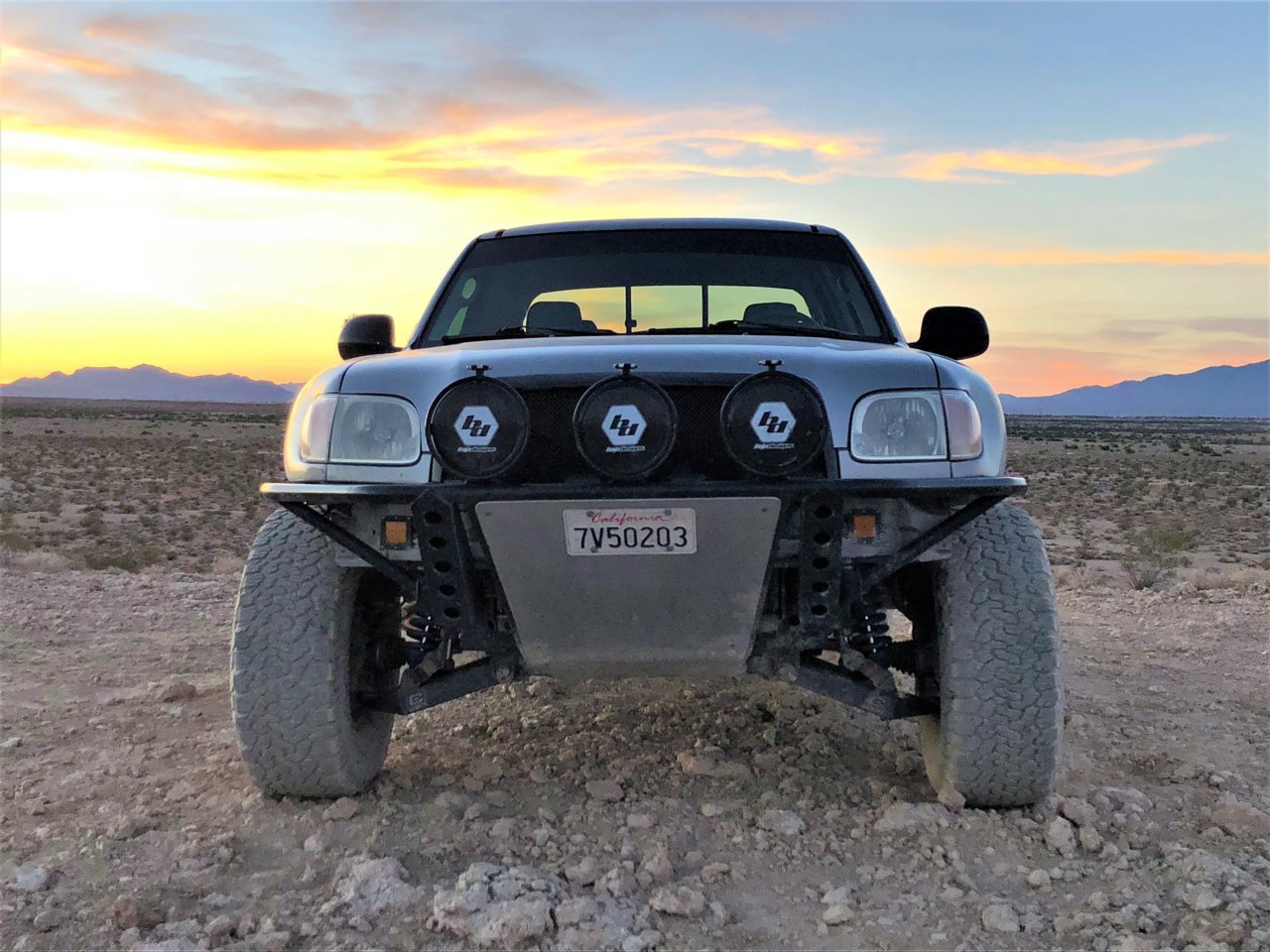

    Took a ride up Carpenter Canyon this weekend. The entrance is off of 160 in Pahrump and is about 5 minutes from my house. Went up to the campsites which I think is near the end of the road. This looks like a fun place to camp when the river is running. There is some water up there now, but just a trickle. The trail is nothing a stock truck can't do. It was fun though. Especially the first leg which takes you through the desert into the foothills on a banked twisty washboarded road. Was fun running it in the Tundra. Got up there hella fast.
    Caught the sunset on the way back.

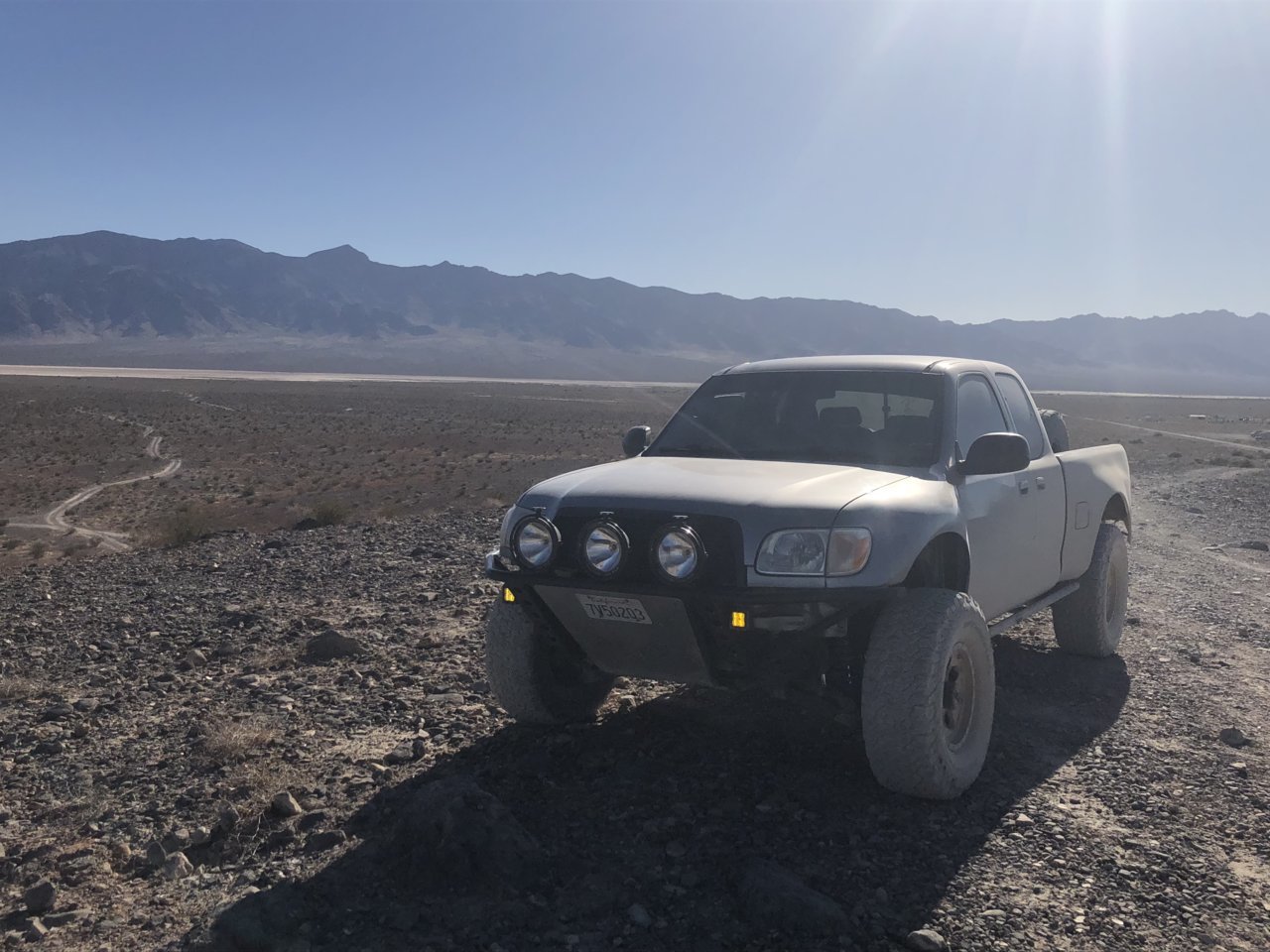

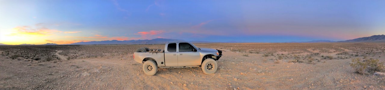

    Went out to the dry lakebed on my lunch break yesterday. Took a few glam shots.

    Man she's perty :headbang:
