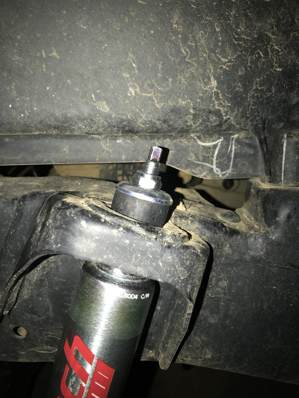

    Last question...all done except I don’t know how tight to make this bolt...where the shock attaches to the frame. Same for the coilover bolt. Did the coilover as tight as I could (minor bulge in spacer was recommended so that’s what I did.) but need to know about the rear shock. And what about setting preload?

    To tighten the top nut on the shock, you need to use to open end wrenches. One for the nut, and a smaller one that fits the very top of the shock.

    Sorry if I didn’t clarify I know how to tighten it just not HOW tight to make it

    Check out the 2nd gen subforum. It has a torque guide.
