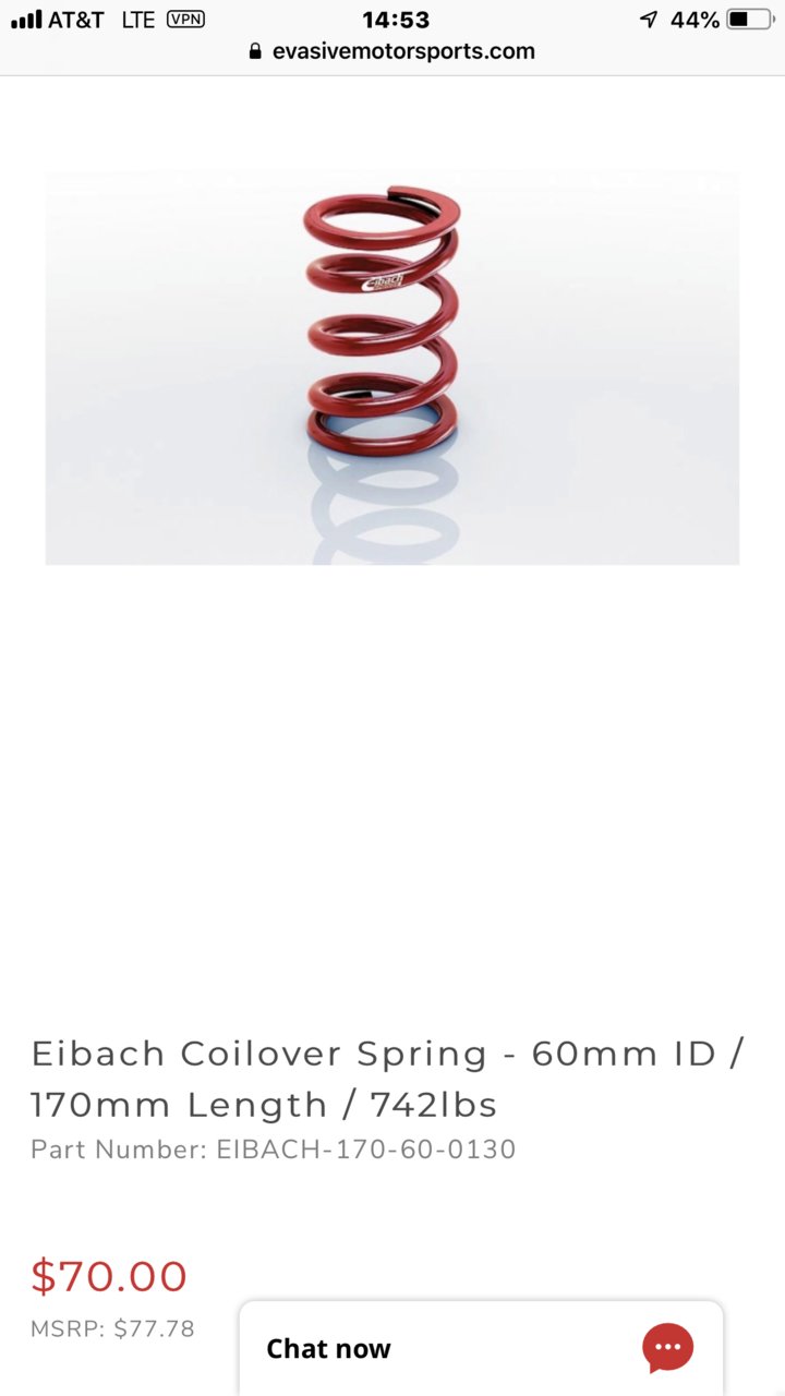

    They have it on their website too. A spring with 742lb/sec :boink:

    lb/sec? Is that quoted from the website? Because that's not even a unit of measure for spring rate.

    No that was a mistake on my part. I dunno jack squat about anything in this area. But they do sell Eibach springs that are 742lbs

    There's quite a difference. The one's for adjustable coilovers are more generic and have a flat top and bottom to the spring. The one's specific to Tacoma shocks have to use a vehicle specific spring perch on the bottom.
    Those are not the right springs. 170mm is equivalent to a 6.5 inch spring which you don't have. Tacomas use a spring closer to 12 inches. That spring is more suited for cars if I had to guess.

    Bro I know that I was just showing you they sell 742lb springs :rofl:

    I won't believe it till I see a part number and its spec sheet saying its for a Tacoma. :evil:
