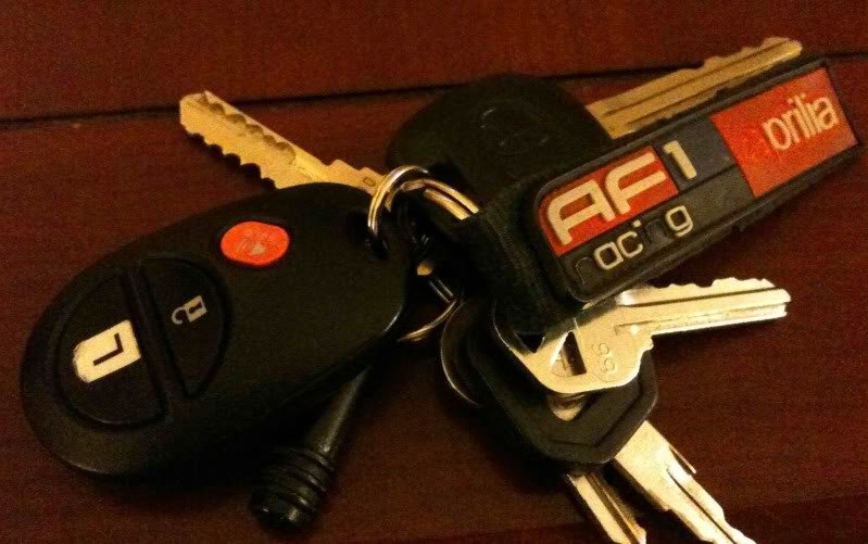

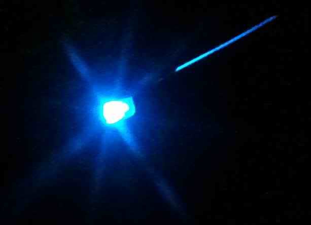

    I bought my 2006 Tacoma just a couple years ago and was told it had an "upgraded" alarm. It has this blue light under the dash uses and the alarm key fob. Can anyone help me identify if it's any kind of an "upgrade"?
    Seems like every so often I'll hear my truck alarm from the house do a rapid succession of horn honks. I'm guessing some sensitivity thing needs backing-off. Well now I notice the blue light really bright all the time.
    Anyone know what's going on and how to deal with it?

    Looks like the stock key FOB to me.

    The fob is stock, but the alarm system could be tied in to use the stock fob. The stock system has no blue LED.

    Do you have a good battery? In the truck that is. I dont know about the light but I had an after market years ago and when my battery started going bad it would chirp occassionally. I didn't know why at the time but later learned it was a warning about the low voltage on the battery.

    If I were in your shoes I would look for the alarm control module, Its most likely going to be a black box. See if you can find a serial number or manufacturer or something and search google for an online user manual.

    x2 if possible follow the wire from the blue light to the box.

    If you push the button near the blue led once it should make the light flash. This makes my doors chirp when locking and unlocking. If you hold the button down for a few seconds the chirping happens when i shut the truck off and it disengages the alarm but the light stays lit up all the time in this setting.
    I sometimes turn the alarm off when I know I am going places where there are lots of loud cars going by because that sets off the warning chirps because yes the alarm is extremely sensitive.

    OK, I did some investigating. Seems the brand is an Audiovox Pursuit. I can't make the alarm trigger though. Also this blue LED (actually it has 2 LEDs & a button). I can't seem to affect a change though. I also couldn't determine the model of it. These things scare me though as usually blind bozos with wire cutters do the install. If I could identify the model (not seeing it on unit) I might be able to make progress.

    PROBLEM SOLVED!!!
    The alarm appeared to be "Valet" mode. Although it was an Audiovox Pursuit alarm, its Valet switching instructions didn't seem to apply. I went sifting through my file cabinet because I seemed to recall seeing some paperwork on the alarm. Among my papers was a sealed plastic bag with Rockledge PROPLM Keyless entry Owner's manual. Inside were instructions including how to trigger Valet mode (cycle key power 3 times).
    Viola! alram works again.
