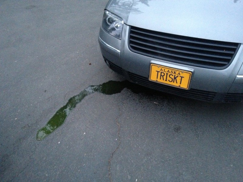

    What does this mean? Friend came over in her passat and it immediately started pouring out coolant and smoking under the hood. My immediate assessment is that it's nothing good haha.

    I would agree with that :)

    I think the car is just drooling for a triskit.

    Did she recently have her coolant topped off?

    She called me yesterday saying her car overheated. So I bought her a gallon of coolant and it took the whole damn thing. I told her to take it somewhere before she does anything, but apparently didn't do that.

    Coolant probably boiled over, my guess is water pump

    I was thinking the same. She had it changed 40k miles ago though. So I hope that's not the case. Looks like a spendy repair either way.

    what year is it? 2001ish? Pretty common in that year VW, they have plastic water pumps, so they shatter often

    Yeah it's somewhere around there. Not sure though.

    Yea probably water pump if it's not spewing out when you pour it in. Other wise cracked radiator. Possible bad hose too
