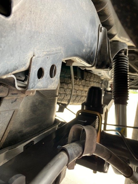

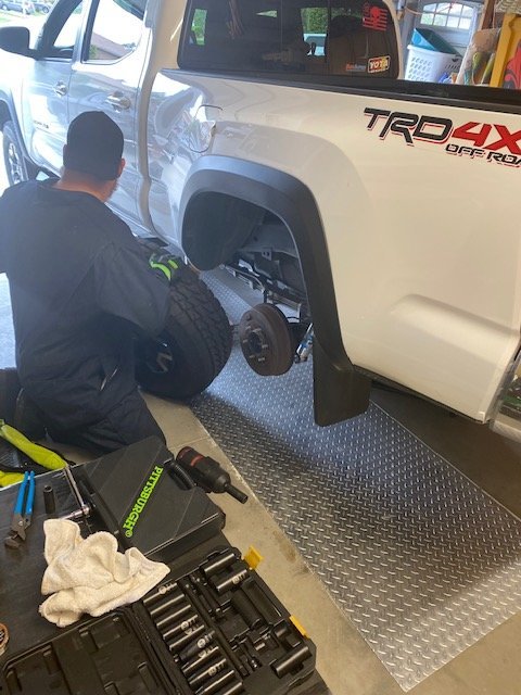

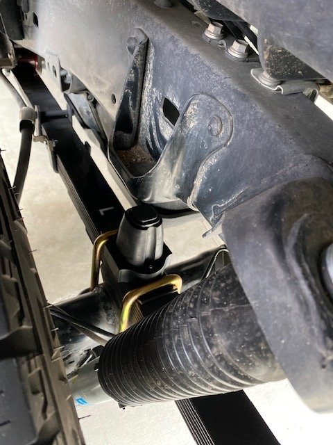

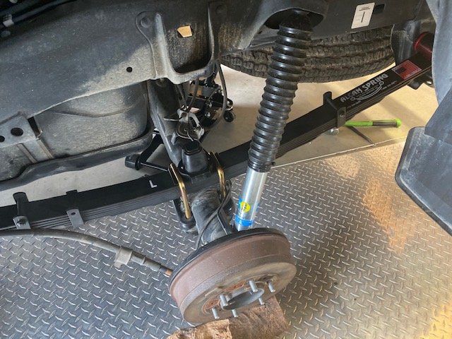

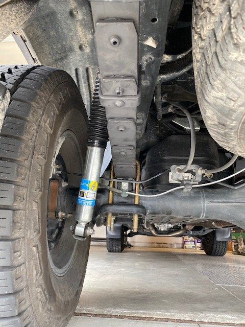

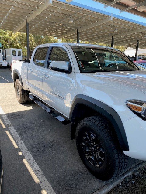

    Hello TW I am new to this site and I am happy to be here! I bought a 2017 Tacoma TRD Off Road 4x4 Double Cab Long Box in December of 2019 and WoW I am so in love with this truck!! After I bought this 4x4 I knew I wanted to upgrade it and make it a bit more off road compatible. I started with the suspension. I also knew I did not want to change the ride height too much because I did not want to deal with diff drops, or carrier bearing drops, or shims. I wanted my cv's to stay safe and the center of gravity to stay low. So I then dove into options for putting new suspension on my truck.
    I searched all over forums, videos, and talked to friends about what the best route would be? I ended up choosing Bilstein 6112's up front and now came the hard part (for me at least) what should I put in the rear? Knowing I wanted a bit of a lift I set the front coilovers to 1.5in and the rear I wanted 1in of lift to give the truck that traditional truck look rake. I looked at ARB, Deaver, General Spring, SD Truck Springs, a few others, and finally settled with Alcan's. The main reason I am writing this post is to set some minds at ease if they are in fact considering Alcan Leaf Springs. I found so many different reviews and posts and it look like half said they are good to go the other half said stay away. Plus many of them were from over a decade ago. I am happy to report that my experience with them has been very positive!
    I called up and talked to Bill on the phone when I wanted to place an order from Alcan. He was very polite and made sure to address all my concerns as well as get all the info he needed to make sure they made the exact springs I needed. I told him I needed 1in over stock height, stock payload capacity, and I would be using this truck for light to moderate offroading and a daily driver. All my info was in and then they charged my cc for $660 thereabouts. About a 5-6 weeks later (not crazy about the wait time but they are custom made) my cc was hit with another $140 for shipping. Because of this Covid 19 I had to change my delivery address a couple times and the gal who handles the shipping was super sweet and got everything taken care of which I am very grateful for!
    Next, I picked up the new Alcan Springs from UPS and drove em home. There were a few spots that the paint had come off in shipping but it was no big deal for me to spray them with some high temp Rust-Oleum and let them dry. I wanted the peace of mind of knowing they were a bit better protected from water and rust. The red bushings came installed and were greased up ready to throw on the truck. Then came the waiting game. I was waiting for a set of front and rear Durobumps for about 2 weeks as I had only ordered one extra set of Ubolts. The install went fairly well and took my brother and I who had never done this before about 3.5 hours. We torqued everything down and took it for a test drive. I noticed the ride was much smoother compared to the factory leaf pack in conjunction with the Billy 6112's up front it yields a superior ride over stock! There is no squeaking and the ride height is exactly 1in over stock which is exactly what I asked for. So Alcan does have my vote. I would buy from them again and anyone who is in the market for a new set of leaf's give Alcan a call, tell them what you need, and they will build it per your specs.
    tacoalcan1.jpg tacoalcan2 (2).jpg tacoalcan1.jpg tacoalcan2 (2).jpg IMG_0316.jpg IMG_0317.jpg IMG_0319.jpg IMG_0320.jpg IMG_0321.jpg IMG_0322.jpg

    Looks great

    Great write up, I’ll keep this in mind when purchasing my suspension lift

    *I meant to put this into the original post I wrote up and forgot. I have not experienced any kind of vibrations what so ever and my truck did not have any wedges installed from the factory. I simply set the leafs right onto the axle and it was good to go. I did have some concerns after reading about the possibility of vibs but after almost a week now of commuting 65 miles to work and back each day on the SoCal freeways I am not feeling anything abnormal with my truck. Hope this helps u!

    Very cool!! I would like to get another set but made to handle 200lbs over stock. I found that going on extended overland trips all my gear almost puts my frame on the bumpstops just leaving my driveway. The 1in over stock with the Alcans and 1.5in with the 6112's up front put the truck about level which I like and it is not jacked up super high so the CV's are in a great position sitting perfectly horizontal.
    The smoother ride is not in your head. The 8 stacked leaf's make for a very plush ride which I enjoy on and offroad. Also when off the asphalt the flex with the Alcan's is way way way better then the stock springs. Nice choice going with Alcan. I am still very happy with mine over a year after I wrote the original post. Take care and enjoy your investment!!

    How have they held up?any issues over all this time? Any leaning?squeaking ? Anything at all. Any axle wrap

    Hey, I apologize for the late response. Life is super busy right now!
    The Alcan's are still AMAZING!! With only 1in of lift in the rear and up front I still sit lower to the ground then I like. The Mobtown skids get a lot of use lol.
    The articulation I can get out of these springs is really good!!! I just drop the tires to 17psi put her in 4LO and I have not had trouble climbing up any hills. Ever!
    This is largely due to the Alcan's ability to keep my rear tires on the ground. These springs just reach and reach and reach until they hit the ground. Very impressive. In the front with no sway bar, JBA UCA's, and Bilstein 6112's with the 650lb spring my front tires stay on the ground. That's my receipt for climbing hills lol.
    The only one issue I had was one of the spacers feel out on the Mojave RD and the drivers side squeaks now but I do not mind that. FYI they also told me they would send me replacements and they never sent them. Sooo... maybe the new owners are IDK.. busy?
    Anyhow. You will not regret purchasing from Alcan.
    Kinda too long this reply is but I want you to know they are good to go and my next purchase will be from them.

    In answer to your first question they forgot to send the spacers. I messaged them through an Insta reply so I am not really holding it against them. I could call them I guess if I really wanted.
    The 6112's were soft in my mind with the original springs. 600lb. Not so soft that the nose would dive when braking but kinda squishy I guess and that is off road with the tires aired down. On the road handling is solid and the ride is much better then factory. Since I have full steel skids, steel bumper, and sliders I knew I needed the 650lb springs. So I ordered those and swapped em out. Now with all that weight and the new springs the truck feels solid again but before the spring replacement my nose would dive when braking.
    The biggest difference in my mind that I can feel is the truck swaying because of the sway bar delete. Doing this has improved the trucks ability to keep the tires on the ground offroad but onroad it feels like a boat. That being said I have taken the truck up to 90 MPH with no sway bar on a straight shot and it feels comfortable to me.
    I have only had factory and 6112's up front. The rear I did have the 5100's at first them swapped em for the 5160's. I do not notice a difference with that except for the heat. With the 5160's I noticed it took longer for the shock and reservoir to heat up. Sometimes they do not even get hot but I usually do longer trips so they eventually get hot/warm to the touch.
    I would go for it if I were you and if you can find them. The Bilstein 6112 front and 5160 rear combo is a winner! They have lasted a year of weekend offroading, DD, and overland adventures without spending $1000's which I do not have. I feel like this is the best deal you are gonna get in that price range. Plus you can change the height, change the spring weight, and they are 60mm(2.65'') and they look badass with the front bumper cut away. Of course you can do all those things with the 5100 but the 6112 are designed for rougher terrain. I hope this helps you!!
