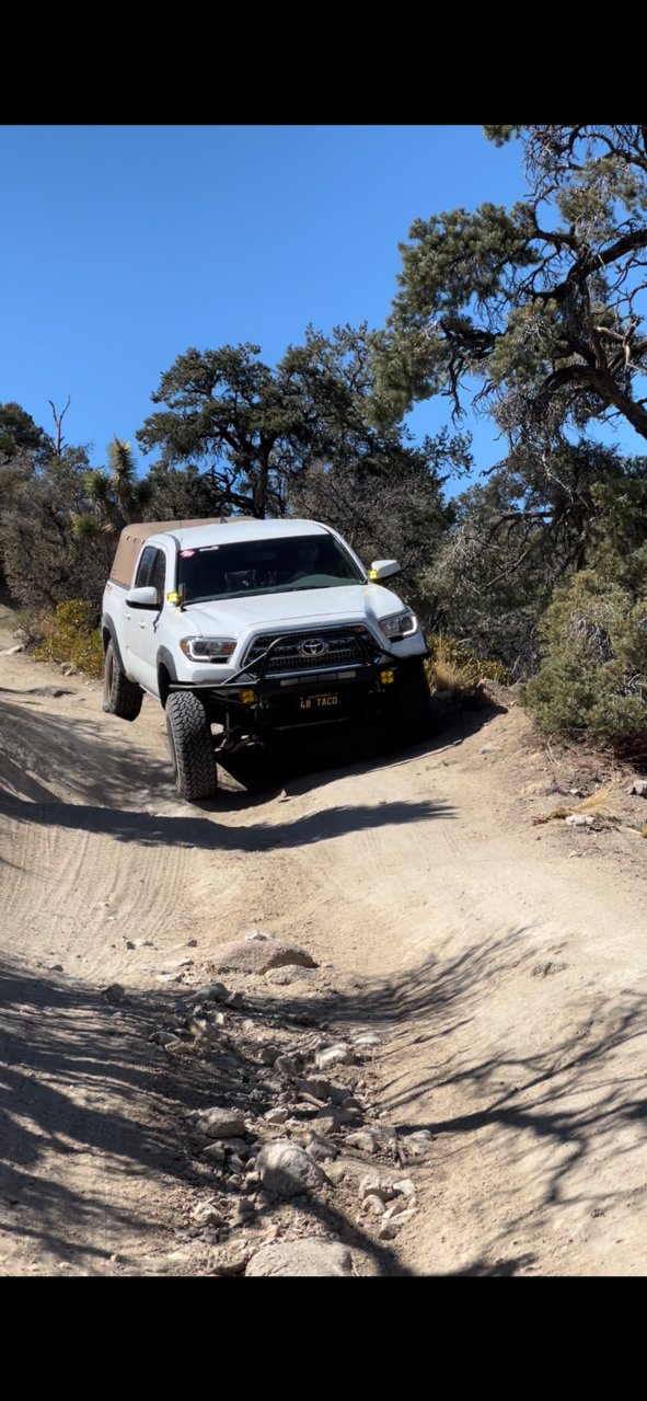

    I have heard that the stock coils are at 700lbs too. But remember the 6112 coils and strut are longer than the stock ones. With an aftermarket UCA and the longer front components you get more flex out of the front end.
    Bil5100 22.17in extended Bil6112 22.56in extended. I hit some rough trails off the back side of Big Bear this last weekend and the 6112's and 5160's with no sway bar performed amazingly! That is with steel skids all 3 of them, steel bumper, and heavy sliders, plus the truck was packed for the trip and two people.
