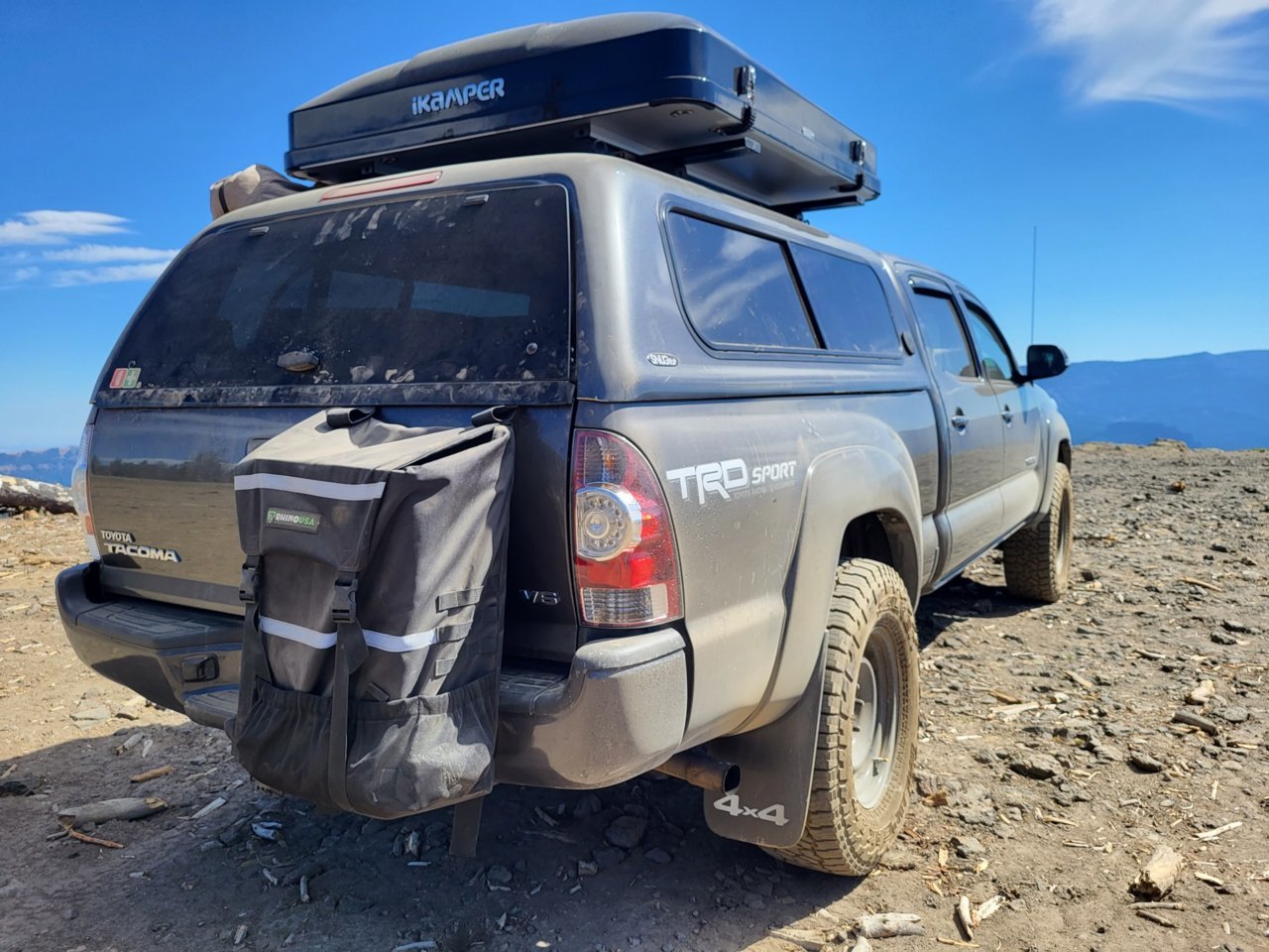

    G2G
    G2G Well-Known Member
    Oct 12, 2022
    #407830
    100
    Bellingham, WA
    2015 DCLB TRD Sport
    Suspension, Bed Slide, RedArc BC-DC Charger, ARB Twin AC, Onboard Water Tank w/ pump, Rear Seat Delete, Front Bumper and winch, Roof Top Tent w/annex.
    I have to give Lew and his folks at Alcan Springs another thank you.
    Supports my estimated 900# rides beautifully loaded or unloaded. No squeaks.
    Made to give me 2" in the rear so I would have to chase my front end.20220816_152005.jpg
