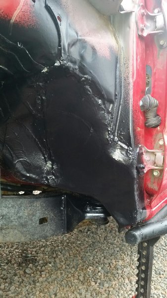

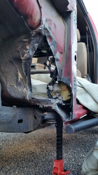

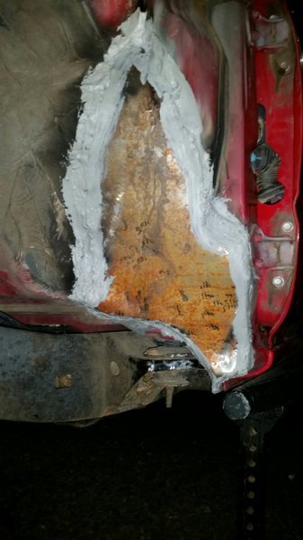

    As of last night (sorry for the crap cellphone images... it's all I've got):
    Finished up the drivers side. Welded in the plate to cover the cutout, seam sealed the shit out of it (inside and out), then applied flex seal to finish everything off/make it look somewhat presentable. Trimmed 2" off the front driver fender and still need to take out an additional notch where the fender meets the door so the tire will clear w/o any rub. There is also a very small area where the tire rubs at full stuff that needs to be pounded in.20160424_181233.jpg 20160425_222408.jpg 20160426_175227.jpg
    Otherwise that side is good to go!:)
    One thing to note is the interior (of which I do not have photos). I had to trim quite a bit on the kick panel for it to fit back into place. It isn't as secure as before due to the fact that we cut out the metal clips which held it in place. After trimming the kick panel, I laid the carpet back over, installed the panel, then put the floor mat down. Looks as good as new.... to me at least.

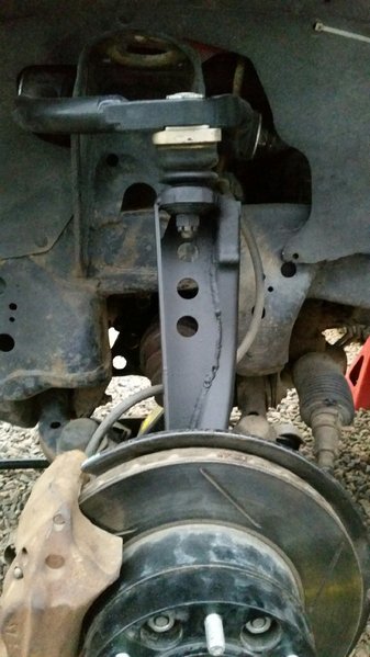

    Here's a photo of the driver spindle gusset. Extremely happy with how these turned out / the added strength they provide. Think I'm going to shoot them with a layer of clear coat to give it some shine. The flat black is a little dull.
