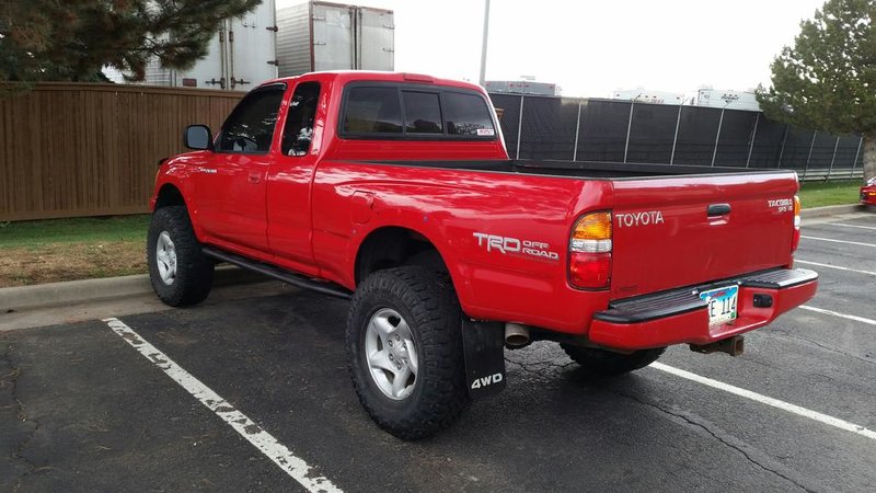

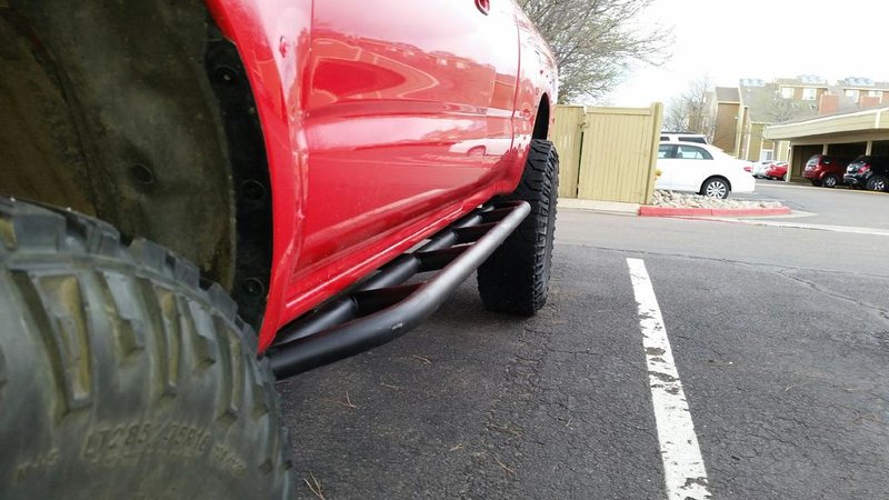

    The first mod I had done was the lift install. It happened about 2 months after I bought the rig, and I don't have any photos left. It was my first lift install, and needless to say it was a pain in the ass. The front passenger side took about 5 hours for the coilover and uca (I wish I was kidding) and the drivers side took about 45 minutes. I relied on the help of a local member to help with the rear install. We had to cut the eyebolts off the factor leaf springs to get them out, and installed the dakars after the dirty work was done.
    Next I had @3378jakesr5 weld on a pair of trail gears sliders.
    I spray painted them for easy touch ups and am happy with the turnout.
    Afterwards I ordered a pair of Relentless Fabrication bed bars and installed them with an old Yakima basket I took off the Subaru.
    I made a makeshift hilift mount for the basket, but eventually caved and purchased the Yakima built mount designed to work with their basket. There's also a bike rack and full size spare mounted to it.
    After the first mods were done I took it out to my first CO trail: Slaughterhouse Gulch.
    3378jakesr5 likes this.

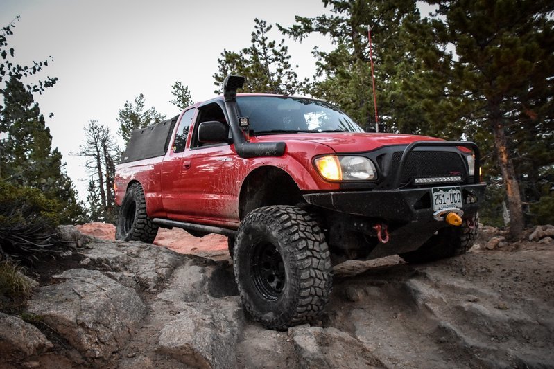

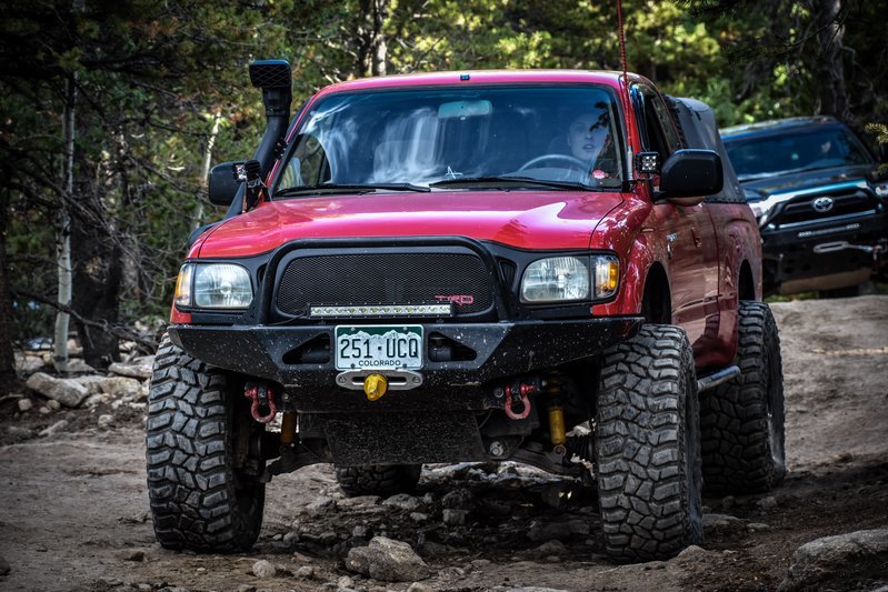

    Next was time for a front bumper. I wanted to go with a plate bumper due to the 883 springs, so yet again @3378jakesr5 came through with an awesome custom built front bumper! I also blacked out the wheels around the same time. The paint job actually looks decent in this photo. It looks like shit right now...
    We took the rig out with the new bumper for a shakedown shortly after. Again headed up to Slaughterhouse Gulch with a decent group of local members before the TW meetup and beers!
    Went for an evening run at Illinois Gulch and ended up covered in mud.
