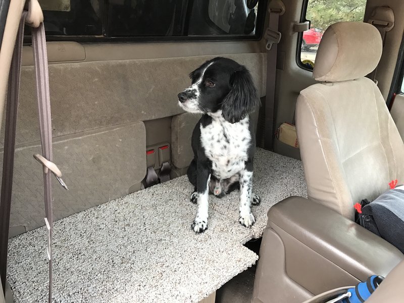

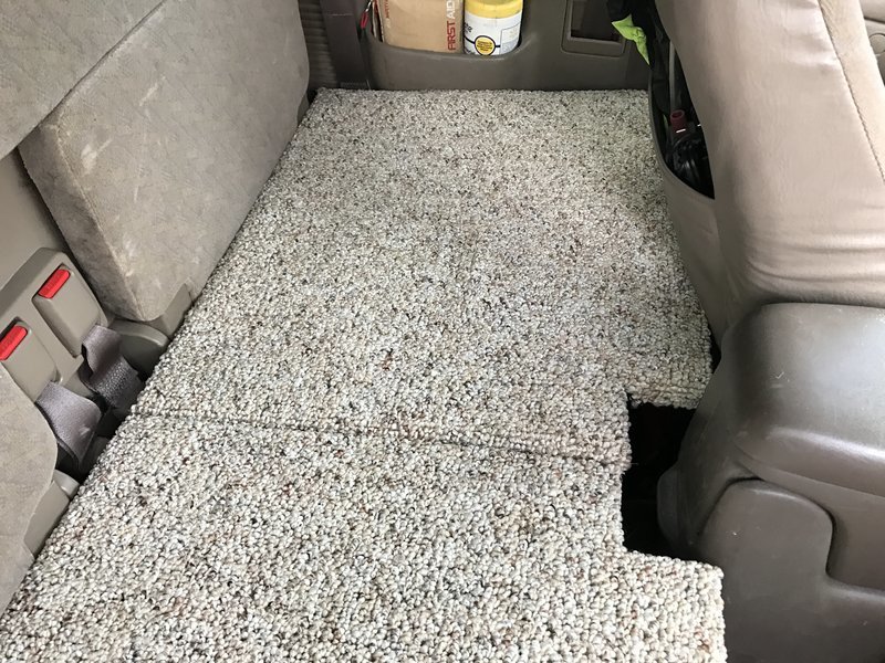

    Got the platform finished up today. It isn't fancy by any means but it works exactly as it needs to.

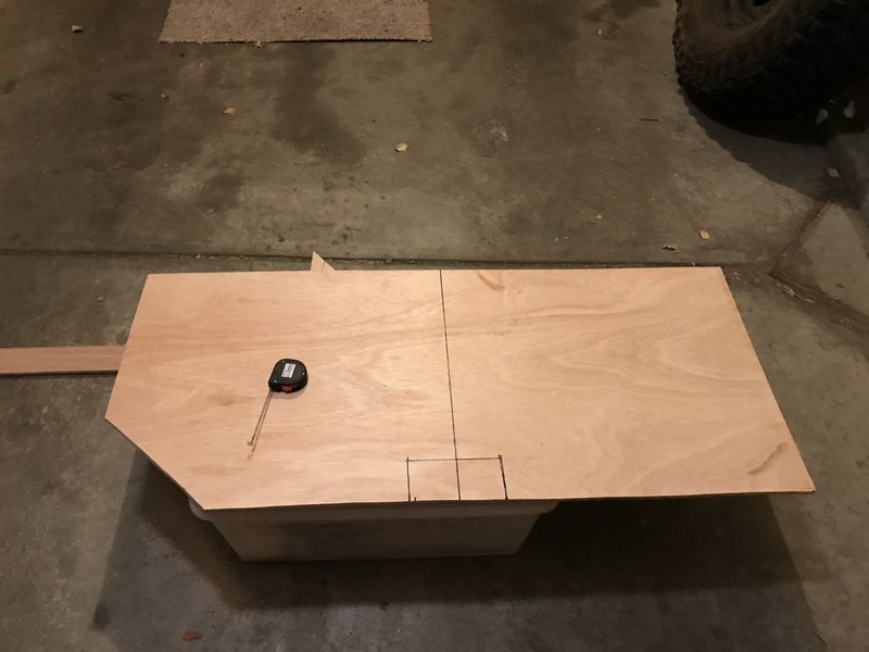

    I started with a 2'x4' sheet of plywood from good ol Home Depot and trimmed it to a width of 21".
    Afterwards I notched out the passenger side corner so the pups can jump into the back with ease, rather than having to clear the platform or jump on the front seat and crawl back.

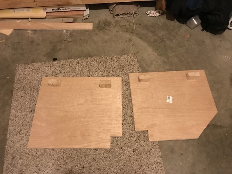

    I then cut the platform into two segments and notched out a place for the center consol. I wanted the platform to be two separate pieces so that one of the pups can still ride in the back seat while my son (or a brave friend willing to cram themselves) can sit in the back.

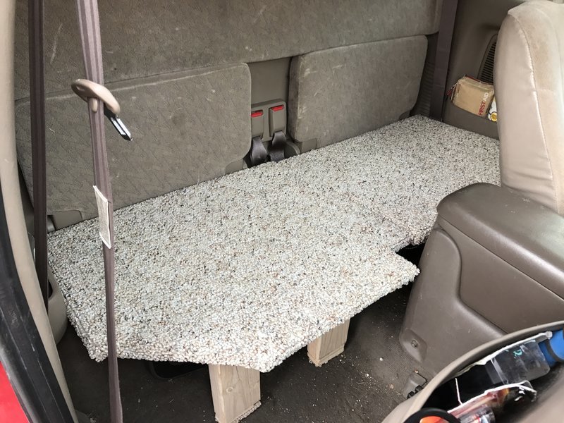

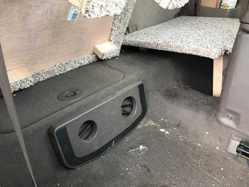

    Once the platform was cut I made some feet. The rear feet are 2" pieces of 2x4, while the front feet are 9.5" pieces. The height ended up being perfect for my needs and I am still able to utilize the space underneath the platform for spare cv's, ropes, etc.
    After cutting was complete I carpeted everything with an old roll of household carpet laying in the garage. I contemplated buying some gray/black speaker box carpet, but cheaped out and used what I had.
    Not the most ingenuitive mod, but a very usable one nonetheless. Having a platform in the back is already far more convenient for hauling things around, tossing things in the back, and of course hauling the dog (and future pup).
    I may brace the front legs in the near future just for piece of mind. Also plan on throwing a blanket over it.
