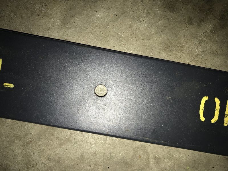

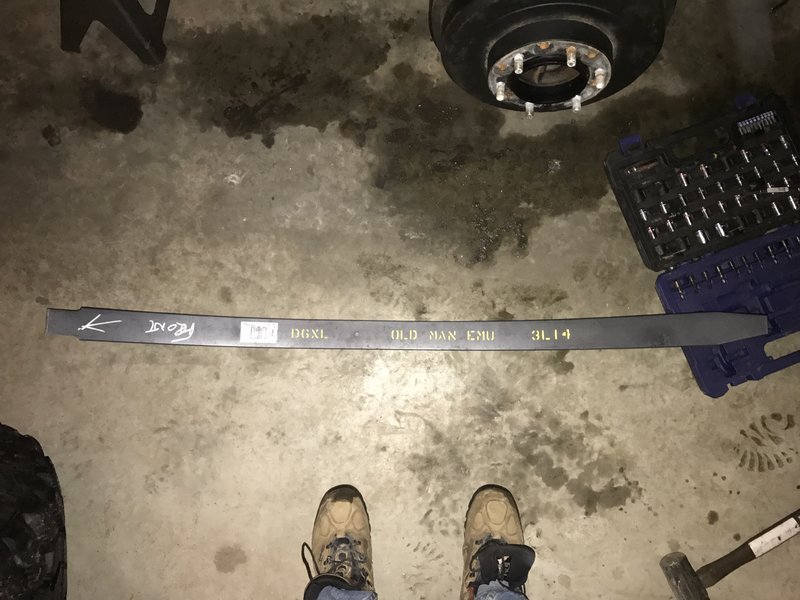

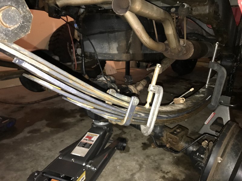

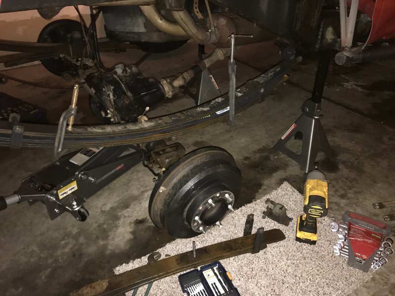

    Got the oil changed and installed the OME D6XL leaf in prep for some additional weight in the rear soon. One issue I ran into was the pinhole on the new leafs not being large enough, so I had to bore them out with a drill. Otherwise the install went smooth for being crammed in my little garage (which is still a million times better than no garage).

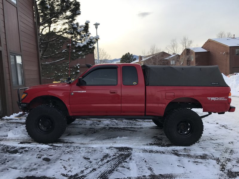

    My parking lot is on a slant and the photo doesn't give much justice.... so I guess I'm just posting an obligatory poser photo.

    You've got quite a bit of weight, though, don't you Kolton? Tent, tool box, bumper, spare?

    Yeah its beginning to be a heavy bish...probably gonna put another one

    I still need to add them to mine, the rack bumper and tent sure aren't light

    It defnitey helps but im gonna put a 2nd and see what happens...

    Shouldn't stack AALs. Will ride like shit.
    You'll have better luck finding a longer leaf that's either thicker or more arc or both and swapping it in.
