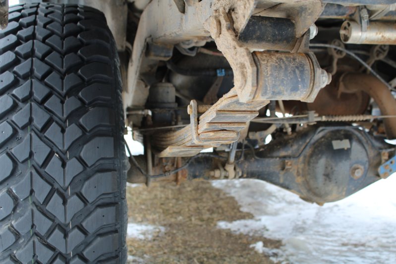

    Speaking of springs, I noticed my passenger set doesn't sit completely flush after the aal install. Anyone have input as to why there is a slight gap between the new leaf and the original on it was placed atop? Something as simple as not being tightened down enough?

    I think they cause more harm than good, being they add a little gap between the leafs to allow dirt in. When Old Brett and I put together my current pack, I ditched the friction pads and beveled the ends of each leaf. My truck makes all sorts of noises, but none from the leafs.
    Where's the gap? Probably the AAL having more arch than the rest of the pack, so it's pushing up from the ends. If so, leave well enough alone and it will settle in.

    Sorry, Brett. Didn't see your reply. The gal is between the aal and leaf below it IIRC. I'll double check tomorrow though
