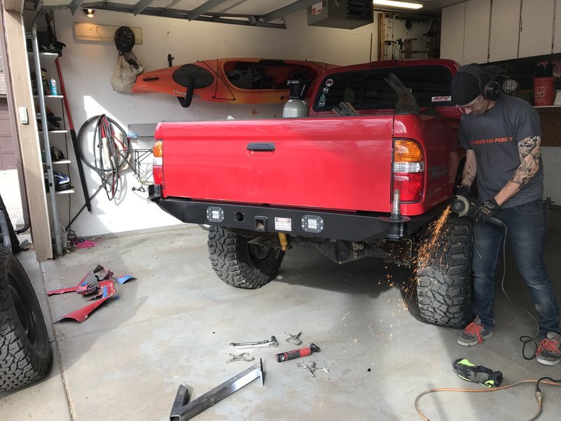

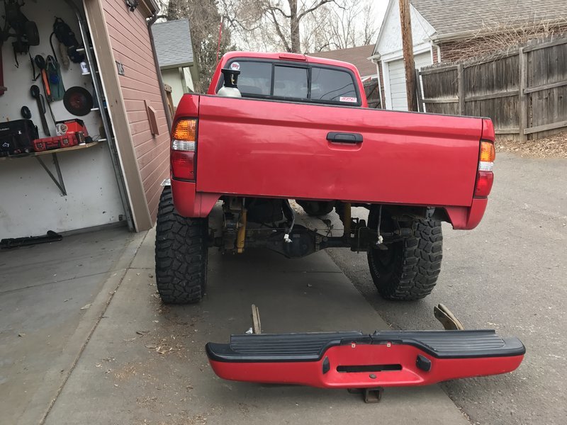

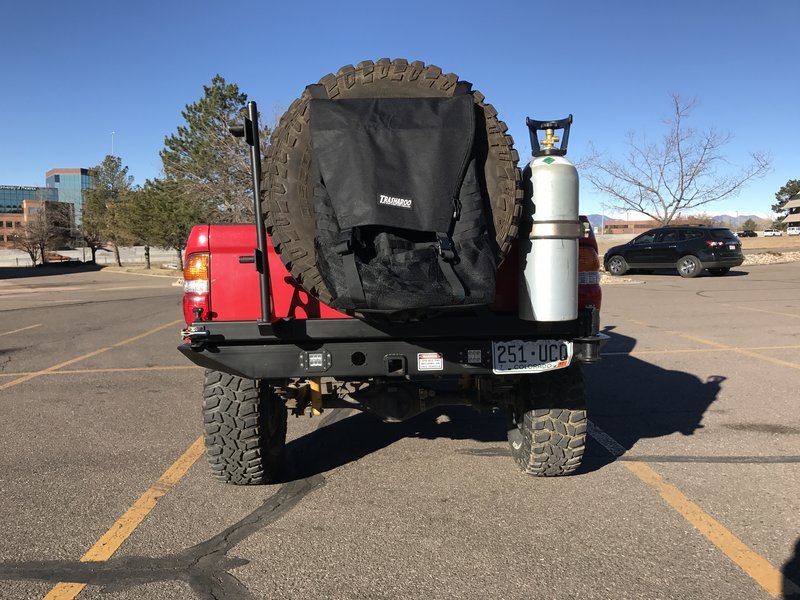

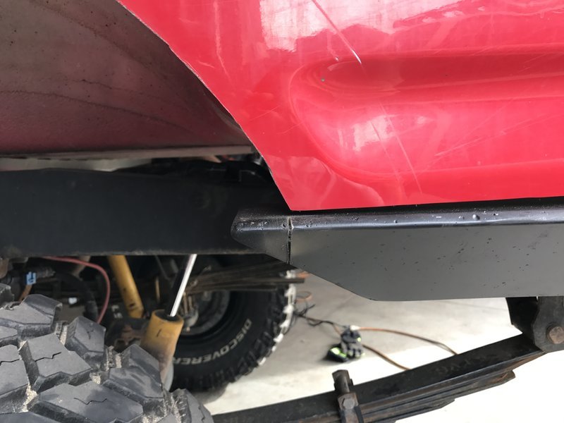

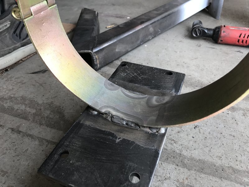

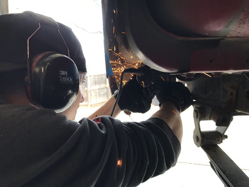

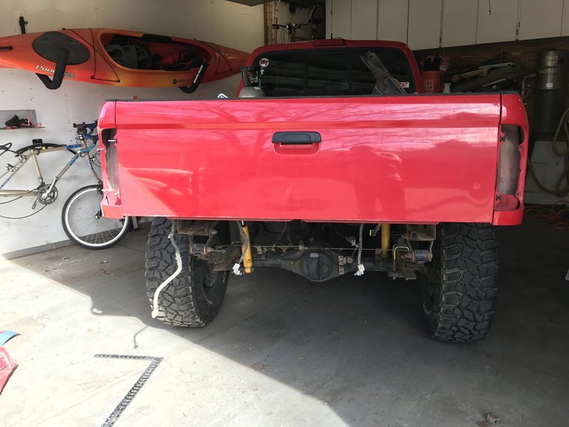

    Quick little bumper build write-up.
    Backstory - The rear bumper was Alex's (@capturecolorado) from his current rig. I spoke with him a few times last fall about building a rear bumper for me this year and that got the wheels turning. Fast-forward to Christmas/New Years, Alex got a hold of me asking if I would like to purchase the bumper he was currently using, as he had intentions of building another one for his rig more suitable for his needs (i.e. bike rack, different sides, etc.). So, I ended up with more bumper than I anticipated during our initial conversations - good thing!

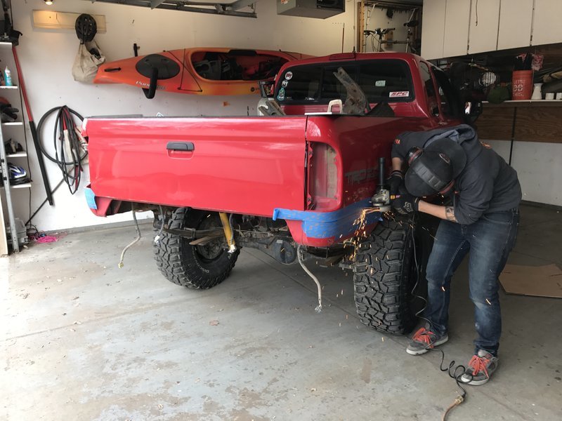

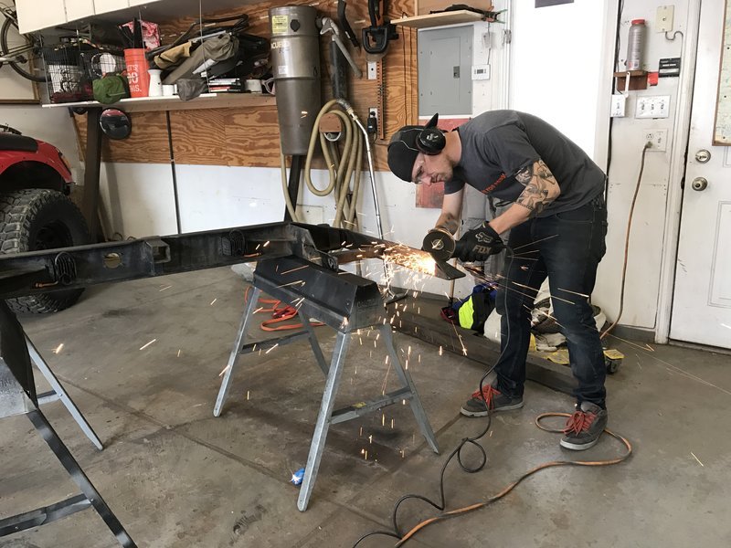

    2/18/2017: Headed over to Alex's shop to cut the bedsides and modify the bumper a bit.
    Started by removing the factory bumper (duh).
    Taped off the sides and measured our cutting line. Alex did not hesitate to grab the cutting wheel and go to town. He did the bulk of the work which made my day extremely easy.
    The end result. Cut lines turned out great, onto the bumper install.

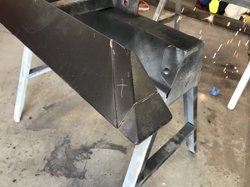

    Once we got int mounted it was discovered that the segments near the wheel wells were about 2 inches too long. This was due to the trimming I did last spring to accommodate 315s. Initially we were just going to hack them off and call it good - Alex suggested we pull it off, cut them at the appropriate angle (45 I believe), the weld in new plates.

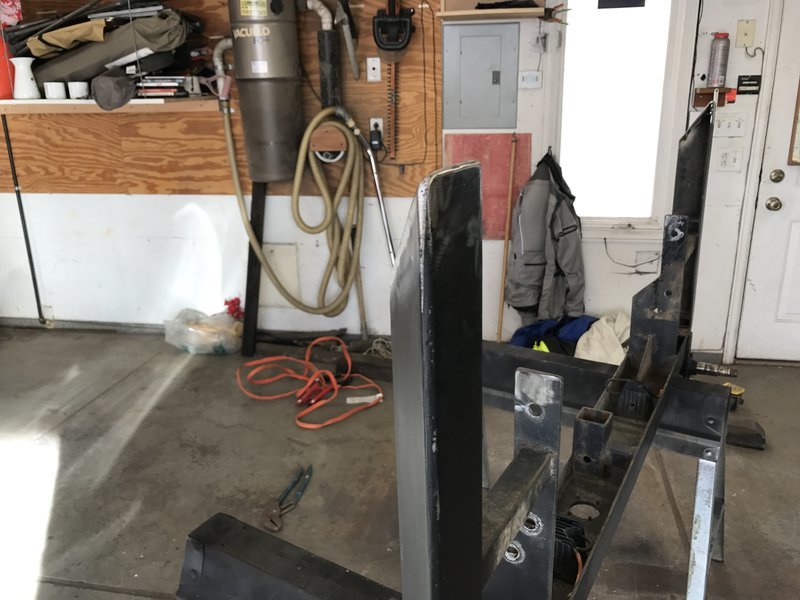

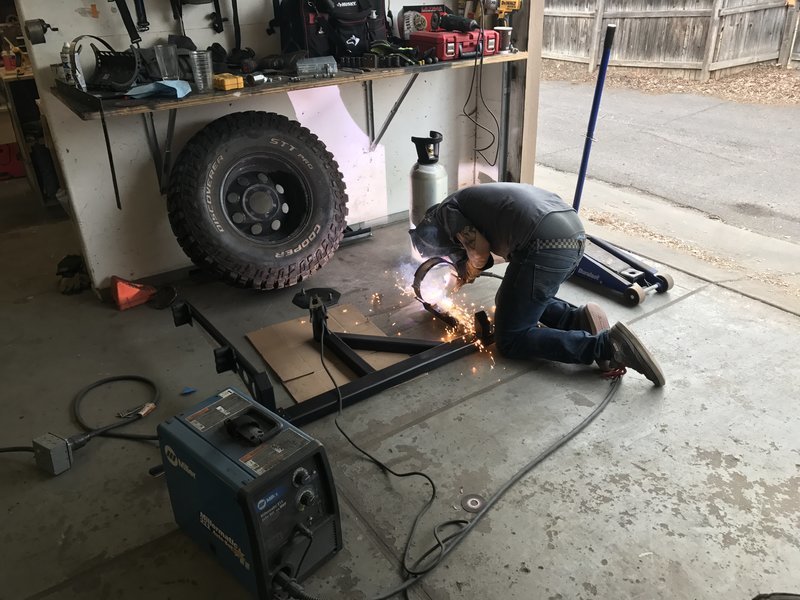

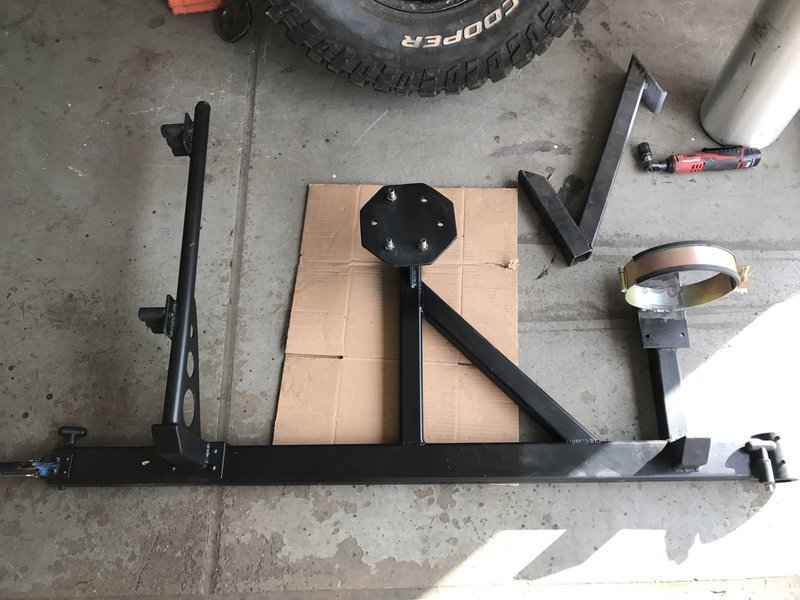

    After the bumper was addressed we went ahead and got the CO2 mount welded up. Since Alex didn't want to give me his Power Tank mount :p, we utilized the mount I had bolted in the bed for the last year or so. A little cutting and welding made it fit perfectly next to the spare.

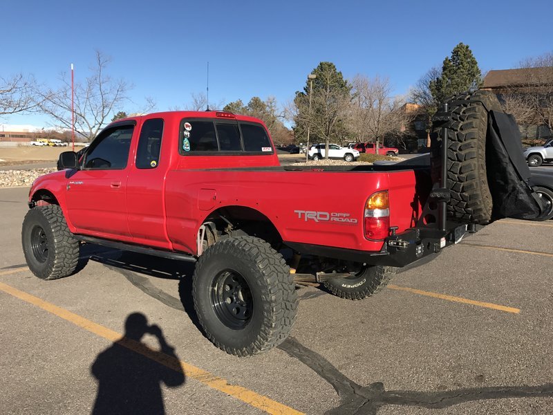

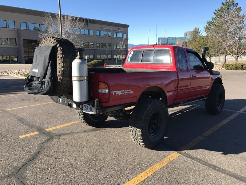

    And the end result!:)
    - After driving with the additional weight over the weekend, I'm greatly looking forward to getting the frame plates welded on. The weight it the back is noticeable (then again I'm comparing to essentially no weight prior to), but not unbearable. The rear has a little more bounce to it now, I may get different shocks down the road to help with the load. Otherwise I'm pretty damn happy with how everything turned out!

    I would get one more clamp on that tank;)
    And it looks good except for the first photo. Looks like you fucked up your truck :rofl:

    It looks like what could have happened at the Denny's in Montrose if I had a little more momentum :p
