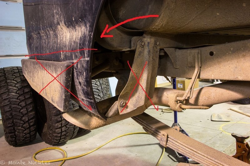

    Mine is not.
    However, i do know a fix...if you still have the part.
    The mud flap bracket is actually the part that holds the part of the rear fender out and keeps it stiff. I cut mine when i did 35s but kept the top section to hold be besides from doing what yours are doing.
    I have no idea if your bumper would intrude on this or if you even have the attachment point anymore after cutting the bed side.
    I'll post a photo just a sec

  5. Feb 20, 2017 at 9:43 AM
    #1025
    Blackdawg
    Blackdawg Dr. Frankenstein
    Dec 31, 2010
    #48500
    81,636
    Monte
    Wyoming/St. Louis
    The Trifecta of Taco's
    This is stock..
    After i cut it.
    Looking at the photos..i would guess you cut the lower attachment point off for your bumper.
    You may be able to weld a small tab to the fender and use the two bolts on the bed to make a custom bracket of sorts for that.

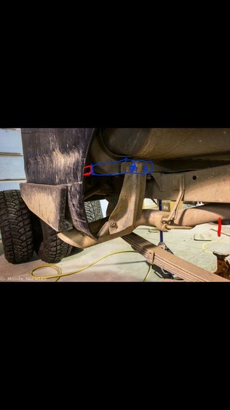

  8. Feb 20, 2017 at 9:51 AM
    #1028
    alee891
    alee891 [OP] Destination: unknown
    Feb 3, 2015
    #147815
    5,750
    Austin
    Black Hills
    Tacomaless
    Where the red arrow is pointing is where the problem is. I'm not sure if the bracket would help fix that as it appears to sit below the portion of the bedside I'm describing. I'm trying to come up with something to essentially wedge between the bed and interior metal to just keep pressure pushed out. Nothing fancy, just something to stop it from flopping around all loosey-goosey.

  17. Feb 20, 2017 at 10:05 AM
    #1037
    Blackdawg
    Dec 31, 2010
    #48500
    81,636
    Monte
    Wyoming/St. Louis
    Just make a small bracket like this.
    Be easy to do
