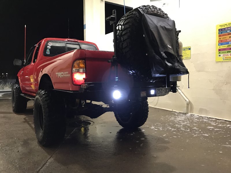

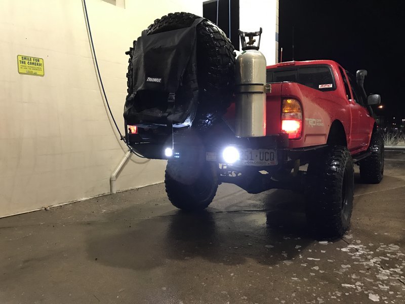

    Piss poor photos, but got the rear lights wired up tonight. Aside from the big ass tire now obstructing my view, I can actually see through the gangster tint that the previous owner had installed.
