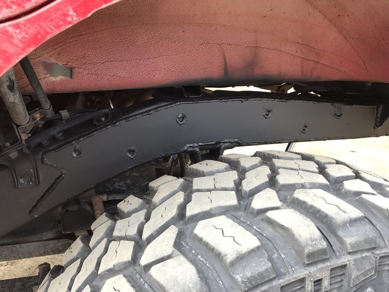

    Daaammnnn! Id say thats pretty good welds for being so long since you have welded lol.

    Are those welded on? or is that just a bunch of chewing gum holding those on?
    there...mandatory shit talking for photos of your welding done haha
    They won't fall off, looks fine to me. Higher heat coulda helped i think. But they will do the job just fine :cool:

    What is the coating on the inner fender well? It looks to be kind of thick.

    That turned out great, Austin!
    How was the plate fit? Any tweaking, or did you just throw them up there and burn them in?

    I'm not certain what the coating is exactly (previous owner had it installed). It's a thick rubberized material of some sort and was installed on the front and back of the vehicle. The previous owner also had a rubberized coating installed on the rear of the frame... but only out the outer portion. Cleaning it off for the plates took a bit of time and caked up a handful of flap discs.
    Thanks, Jason. The plates fit up perfectly. I had to cut a notch in the rear end of the drivers side plate in order to sit flush around a stud that was welded to the frame (I believe it was for the factory bumper :notsure:), otherwise we just placed them on and started welding.

    Frame plates look good man! I can't decide if I want to do this yet or not. Was thinking about just boxing it instead and setup new shock mounts/u bolt flip at the same time.

    If I had the time, tools and funds I would do that! Won't be getting around to a complete rear overhaul for another year or so. Factoring a box kit, new shocks, ubolt flip, possibly new springs - adds up pretty quick. Frame plates were needed before wheeling started, especially now that I have so much weight hanging off the back end.

    Those look better than my CBI plates too. Mine end at the bed mount and those go all the way to the shackle hanger. :thumbsup:

    That was the hardest portion to weld (with the bed on). We don't speak of those welds :oops:
