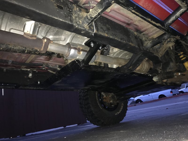

    It may be ugly, but it was built with love and will take a beating. Thanks again @Reh5108 for letting me copy your skid and use all of your tools.
