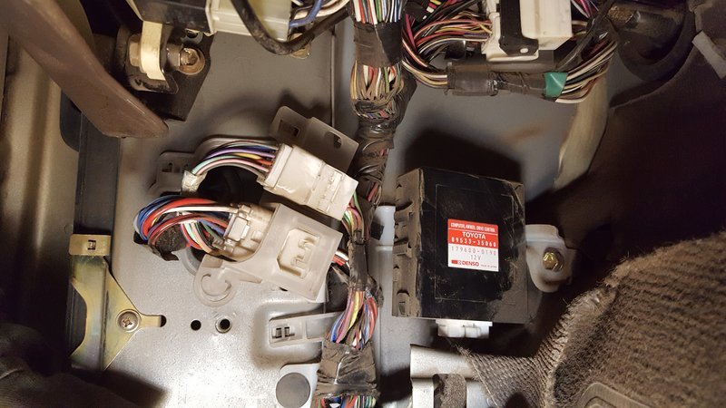

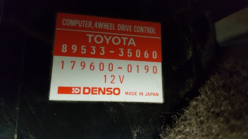

    @alee891
    I got a spare locker box thingamajig under the driver kick panel. No idea what the numbers are on it. From a 02 Dcab auto.

    Pics of location and said thingamajig?!
    @thefatkid any input on this being a potential candidate for a fix?

    AFAIK black box under driver kick panel, search grey wire mod for location info. You ground the wire coming out of it.
    I'll be home in a few and try to get a pic of the numbers on the box.

    Is there any way to tell if the unit is still operational?

    Im not sure frying that would fry just the elocker..
    You wouldn't have 4wd either.
    have you done the grey wire mod?

    I'd try that perhaps. It'll bypass some of the control and basically make it a fire when you want relay. Could actually help figure out what the hell is going on.
    Or get a volt meter out and pull the plug on the e locker motor and see if there is voltage going to it in the correct way when engaged. If not. Go too the relay and try bypassing it or cleaning it.
