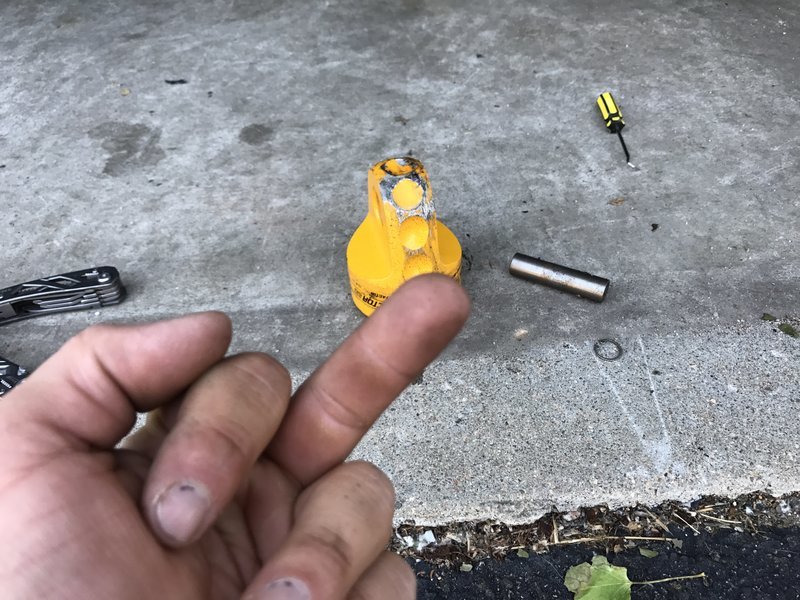

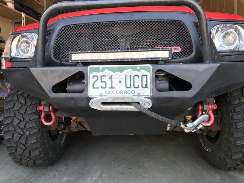

    Fixed the winch and got rid of the chode link:

    You don't think the hook is now sitting even lower to drag? Seemed like clearance was the issue, not brand of apparatus.

    Yeah the winch position looks rough for approach angle. The hook will just hit small rocks now. I bet it rarely gets touched.

    @alee891 is there any damage on the hawse?
    If there was enough contact to hook the top of the factor 55 and pull it down, seems like it could easily hit the hawse, which means instantly shedding through the rope now.
    Not defending the nipple since it is huge and sticks out a lot

    No damage that I noticed. And exactly what you asked is what kept happening with the prolink - it would get hung up on everything.
    As @Gramps explained, the approach angle was greatly reduced with the pro link. The original winch hook may now be slightly lower, but that and the D-ring have the ability to move out of the way, and are also a bit recessed on the bumper thanks to @3378jakesr5 awesome bumper design. The prolink was fixated and just smashed into everything lol.
