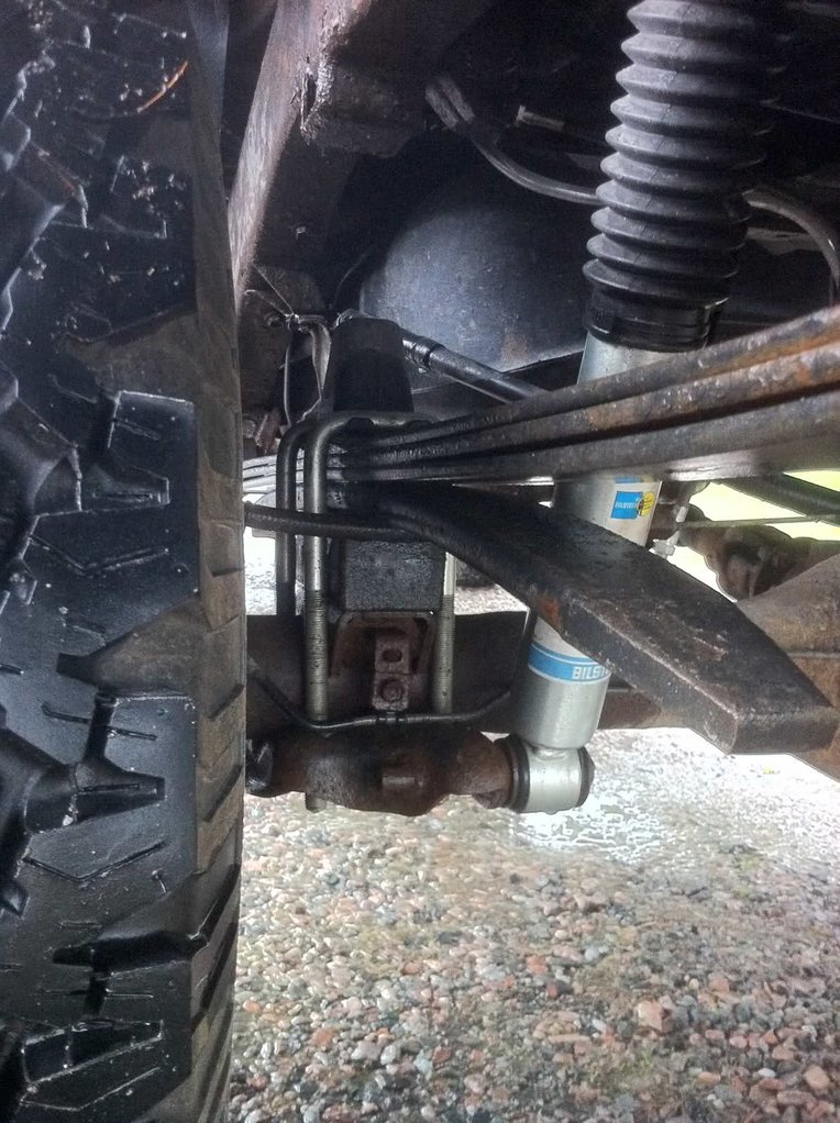

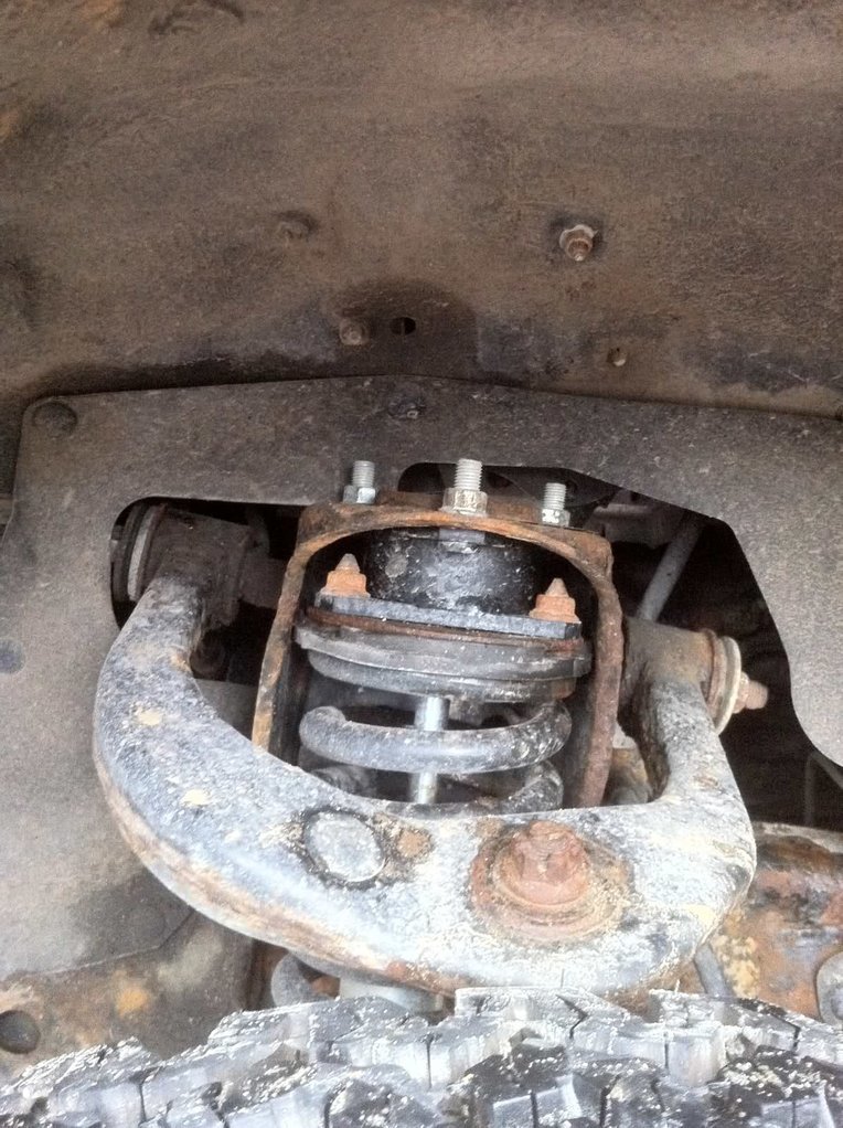

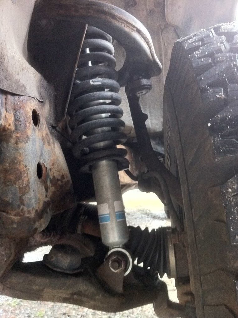

    98 tacoma xtra cab 4x4. He has a K&N cold air intake with Gibson exhaust.
    He is on 4 inch lift at the back: 2 inch blocs and 2 inch shackles and 3 inch spacer in front with blistein 5100 series adjustable shocks. Front shock are at first ajustment.It has 33's Bfgoodrich A/T KO. Extented rear brake line, diff breather relocated at the gas cap. Front stainless grille to come with maybe cut-out fenders.

    2 Inch shackles
    2 inch blocs
    3 inch front spacer
    Front Diff drop
