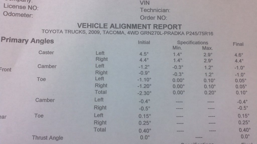

    i had a perfect talignment before a offroading trip.....no the shop cant get me above -1.7 camber........my wheels look like ( / \ )

    Toytec coilovers ( eibach springs and 5100's) and total chaos UCA'S ....
    Edit: and maxtrac Spindles.

    I took the truck into an alignment shop and they said they are ok and shouldn't prematurely wear the tires...

    well yours look worse than mine......but my numbers are worse :eek: im going to replace the lca

    I'm running Camburg spindles with stock UCA's and stock coilovers. Was able to reach 0 Camber .03 toe and 2.2 Castor
