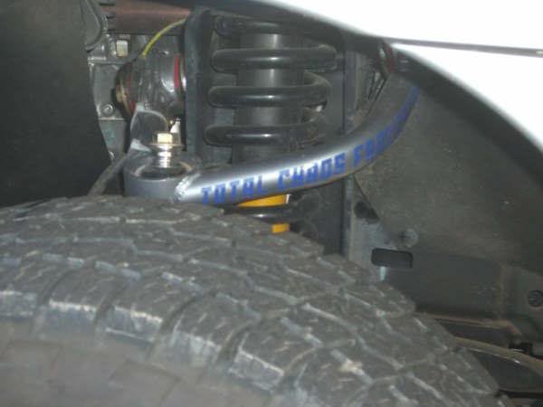

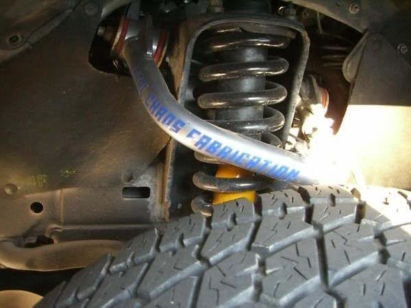

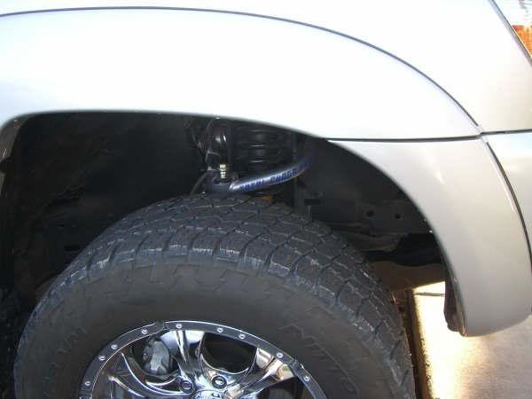

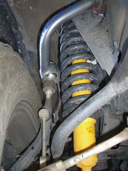

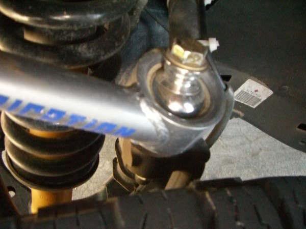

    Its alot of money to swallow, but if you get it, you wont regret it. Stronger than stock, adds a little bit more travel to your front end, adds caster, and looks COOL. I'll post some pics. :)
  12. May 19, 2008 at 6:33 PM
    chris4x4
    chris4x4 With sufficient thrust, pigs fly just fine. Moderator
    May 8, 2008
    #6497
    112,751,691
    FlimFlubberJAM
    Tenoe, AZ
    2019 Rubicon 4 Door,
    4.10 gears, sliders, and lots of buttons.
    Here are the pics.:
    Hope these cover all the bases. :)
    Also, they are fully serviceable, just cant see the grease zerxs thru the dirt.
