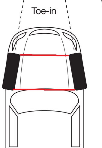

    It just means they didn't adjust equally. So for 0 toe, you want both tires dead equal with each other between the front and back of the tire. As illustrated, you can see the front of the tires are closer together. To correct this, they need to lengthen the tie rods to push the front out/suck the back in.
    The correct way to do this is adjust each tie rod equally. The lazy way is just adjust one a whole bunch. This is what can lead to one being "maxed out" and a crooked wheel.

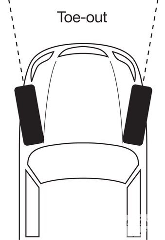

    Now if it were like this, they would be shortening the tie rod. This would bring the front end closer/widen the back. Hopefully this helps you sorta conceptualize what's going on here.
