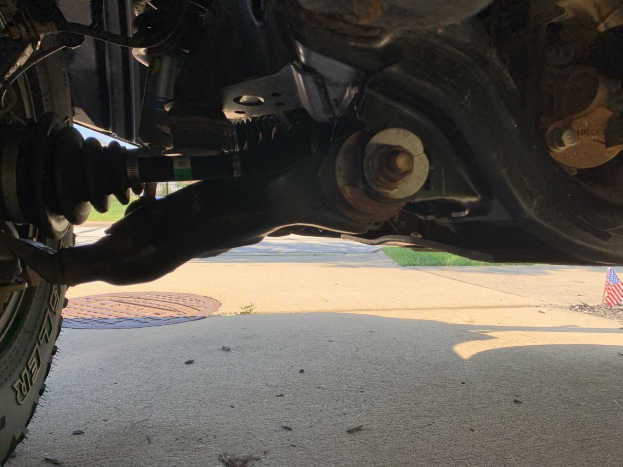

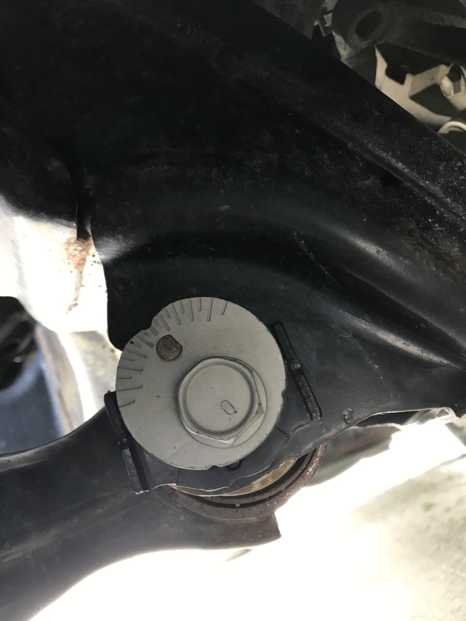

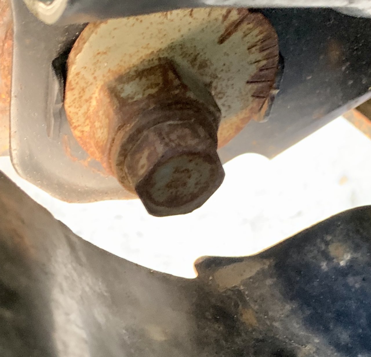

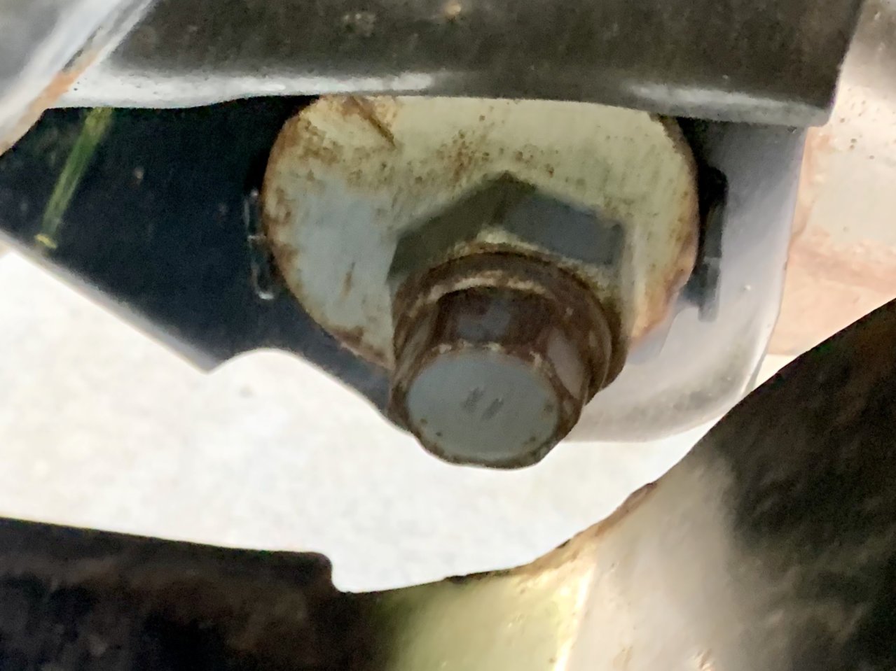

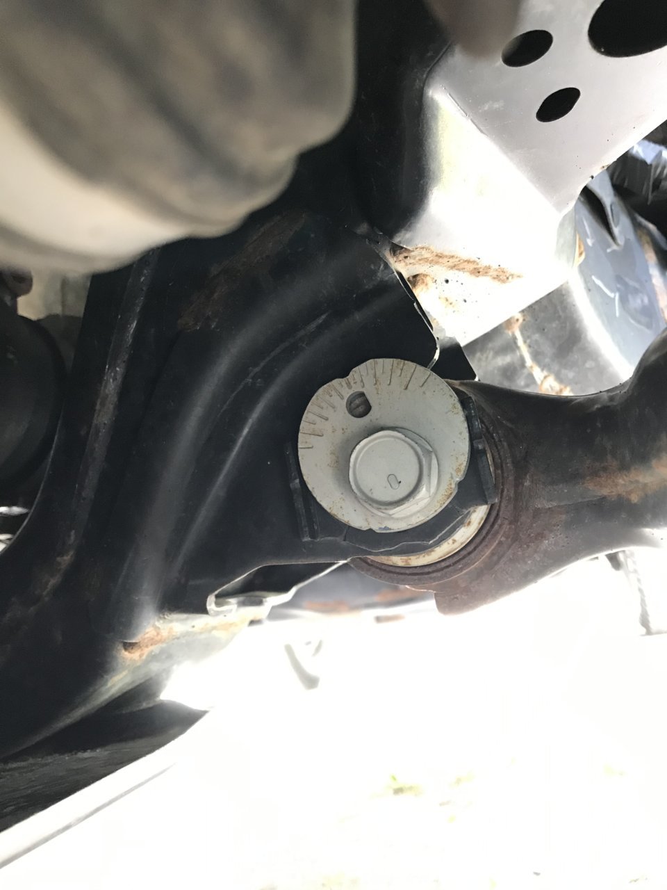

    I would get under it and see what notches each bolt head is pointing to. That way you could see if the right was pointing at 3 notches to the right and the left is pointing straight up or something like that. If the don’t mirror each other (somewhat) that may be an indicator that they need to straighten it out some more

    Here is what I was talking about. I did my alignment myself and the bolts mirror themselves. Very straight and tracks like a scud missile. As far as the steering wheel, that’s as easy as using the seat belt to “lock” it straight, but good shops have special tools for that. Sounds like you need to talk with the boss at the shop.

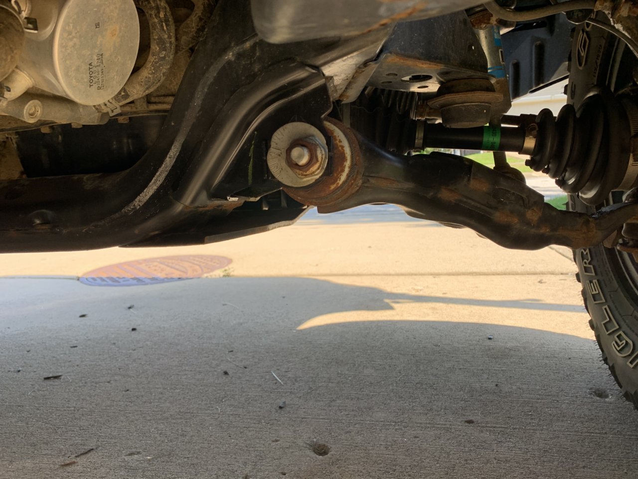

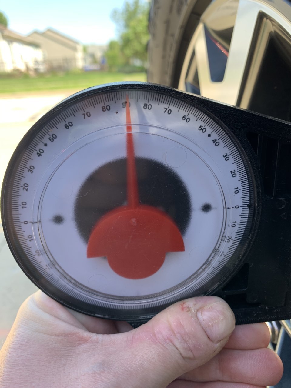

    Yeah, Ohio man. The rust just grows on everything! I go through WD-40 like crazy cause I spray the UCAs and leaf springs down twice a month. Still...rust SMH
    I got 5100/887s and stock UCAs with a single AAL out back. Similar setup. I ended up with roughly 2” all around. I’ll take pictures of the front UCA alignment bolts and you can base yours off of that for comparison.
    my alignment got me:
    Caster: 2 ish (from my calculations)
    Camber: -.5
    Toe -.1
    Angle finder picture shows the camber, couldn’t find my good digital one.
    the other pics are of the front alignment bolts...sorry for the crappy quality. My skid plate is blocking the bolt and I had to shove my phone up under there to get the shot.
    You can see what notches they are pointing to. The bolts are almost maxed but definitely resulted in a good alignment. Tire wear on my duratracs are awesome.
    I’m curious how far off yours is from mine...

    I took pics a bit ago. First is passenger side second is driver side.
    Pulls towards passenger side and steering wheel is clocked toward passenger side.

    The suspension thread has a sticky for DIY alignment. That’s where I learned to get mine done in my garage. So much better than paying some tech to get it “within spec”
    Good luck with it, post results

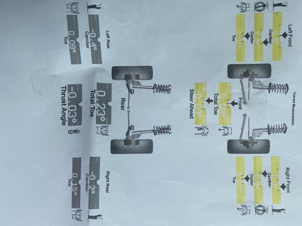

    Took it back and they fixed the wheel. And by fix I mean now it’s very close to straight but not perfect still. Whatever, I can live with it and next time I’m finding a shop that is good with these kind of alignments.
    My final numbers are:
    3.9 and 4 caster
    0.4 camber
    0.06 toe
    I did notice after a long trip yesterday that my fronts have more wear on the outer edges than my rears. Brand new tires so I can see where everything wears first. I’m assuming this is normal Since your fronts are turning/moving under force more while the rears stay straight?

    Your camber (old camber) was pretty positive, my tires wore the outer tread pretty quick on my stock tires because of that. Your toe on the sheet ws pointing left which would explain why your steering wheel would be off center to the right.
    on the bright side, your caster angle looks good
