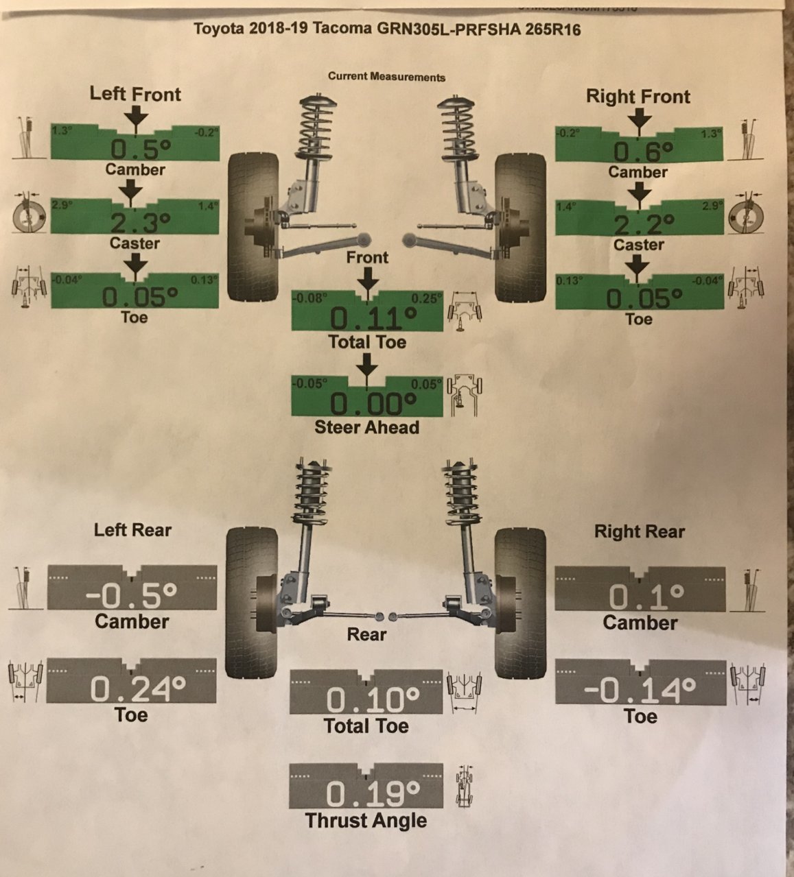

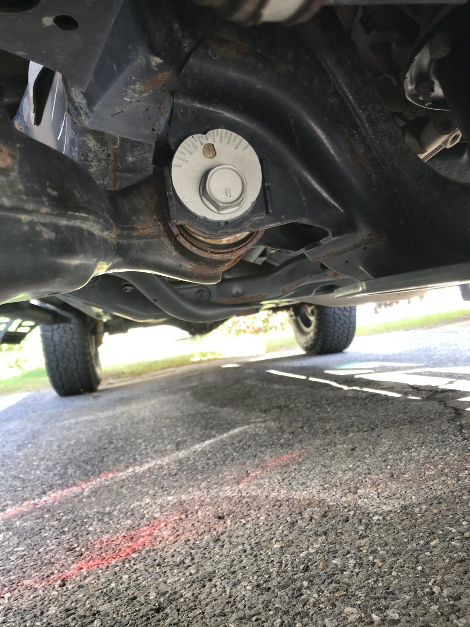

    Went to the Toyota dealer today. They realigned the truck. Caster was out, I don’t have the before only the after.
    The truck drives normal again, no pull and the steering wheel is dead center. Weird after just a week how much I’d gotten used to it being “off”. Drives much different and in a good way.
    Head service tech at the dealer is a straight shooter, real good guy. Met with me before and after the alignment. I told them the history of two previous alignments before they checked it out. Did at no charge. That was a big surprise seeing as I didn’t buy the truck or tires there but they do my regular service. Very happy, I’ll buy my next vehicle there if the price is right and he’s still running the shop.
    The printout is attached along with the new cam bolt positioning. @krootz EA154F11-6AF4-48B5-99C7-E0477A50C860.jpg59D96BB0-3D06-45E5-93F2-ED932764350E.jpgA5ACB0B7-3D47-4339-B281-2DDA66F1D8D8.jpg

    Now THAT is a good alignment. This is a good example of what right looks like in my book. Sounds like you found a great shop to do business with if he did it at no cost with those numbers! :thumbsup:
    It’s funny how much better it drives when it’s dialed in. No more fighting the steering, no wandering on the highway, return the center is faster, etc. Mine would “dance” and get sketchy over potholes until I got it adjusted right.

    I take it you’re stock otherwise you’d want that caster more positive.
  9. Jun 6, 2020 at 7:09 AM
    #89
    CementedTaco
    CementedTaco Well-Known Member
    Aug 12, 2018
    #262573
    106
    J.
    Usually in the woods
    2018 Tacoma Cement TRD OR 4x4 Tech + Premium
    All stock except a small bump up in tire size to 265/75/16.
  10. Jun 6, 2020 at 7:11 AM
    #90
    ejewels
    ejewels [OP] Well-Known Member
    Dec 13, 2017
    #238387
    1,669
    CT
    2018 MGM TRD OR 4x4 DCSB
    6112/5160/Dakars/Pro Tacoma Wheels
    Yeah should be good then. My caster is at 4 but I have JBA UCAs and a lift
