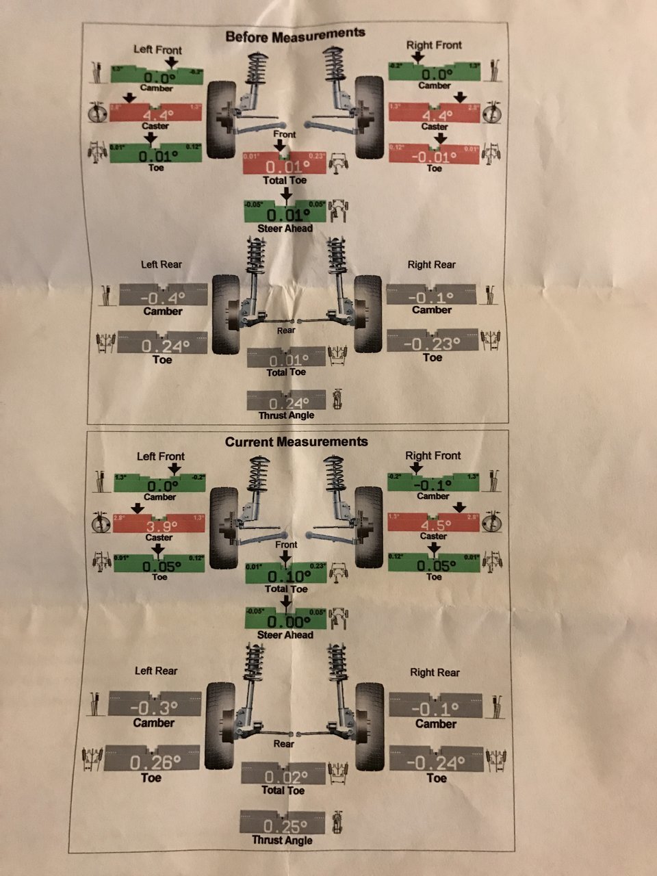

    Proof of what I'm describing works. This is mine from doing it in my garage (the BEFORE) and then when the shop changed it just a bit (the CURRENT):

    Damn you did pretty good on it too

    So if I had a alignment like that it would steer good and have good clearance?

    Thanks! It really is easy reading the guide in the sticky above. Only money spent was on a digital angle finder.
