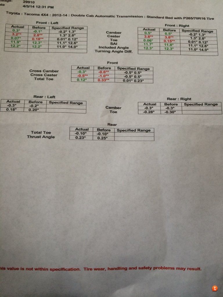

    Your caster is bad on passenger side, they didn't do anything because everything else is in the green.

    Updated alignment numbers I went with another tech but it drives a lot better then couple days ago
    What you guys think?

    Did they mention anything about the alignment cams being seized ?

    They said it's not seized I mentioned that to them to see if they were but the truck drives straight as an arrow now...much better on freeway ten before

    Interesting they didn't match the caster numbers a bit closer

    I've read good things about those can bolts

    The truck only has 25k mi on the ODO you think they be seized

    Mine were

    I don't know that I've seen anyone going to over 4 caster on a Tacoma

    My caster would be good according to your specifications

    Where would I grease the cam bolts for maintenance?

    You remove them , apply grease and re-install
