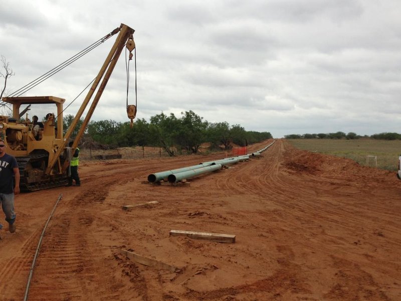

    pipelines ? severe duty mang !!!!!!!
    there is no harder job on earth for equipment. only mining is about equal.

    It's rough on trucks! The mountains and swamps you have to drag your trucks in and out. Then whenever your down south here you have the dust, heat and horrible roads. So it is always something with a vehicle!
