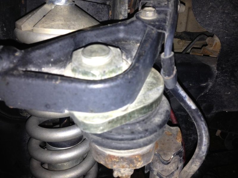

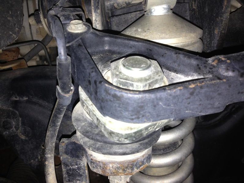

    I just got off work and got to the camper. I read over everyone's post and it all seems to be tight. I jacked up both sides and couldn't get either side to give any or have play. Like i said in the earlier post, but excluding the rack everything is pretty new.
    I did notice and it may not amount to a hill of beans but both caster adjustments for the LR UCA weren't in similar locations on each side. I am no alignment genius but they looked a bit off to me. Ill post pics as soon as I send off my report.

    Driver side

    Passenger side
    And sorry that I'm posting pictures this way! I have yet to figure out this new I phone.
