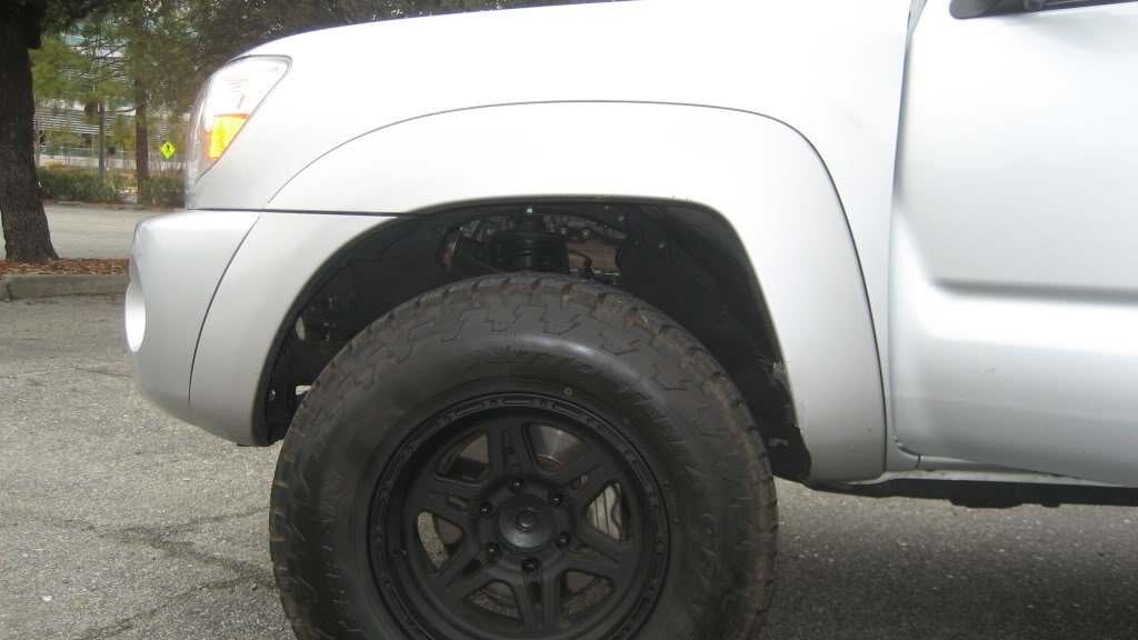

    Went to go get the truck aligned today at my local shop but they couldn't get the caster in spec - no surprise there.
    Tech said he saw all the sand under my truck and assumed that all the jumping and romping that I've done at Pismo ruined my caster. He concluded that it's my frame and how it might be bent, blah blah.
    I personally believe that my stock UCA's are the root of problem. He said aftermarket UCA's won't change a thing. I beg to differ.
    Caster came out to be 1.1* on the left and 0.5* on the right. I am hoping some LR UCA's will solve this problem.
    Also, can anyone CONFIRM my 5100's are set at 2.5 by looking at this pic? I can't tell! I'm starting to think they set them at 1.75". The truck seems to be sitting kinda low.

    There are 4 notches on the shock body- If you don't have the collar all the way to the top one...You set them low. No real way to tell from that photo.
    I would give some LR UCAs a try andfind a new alignment shop.
