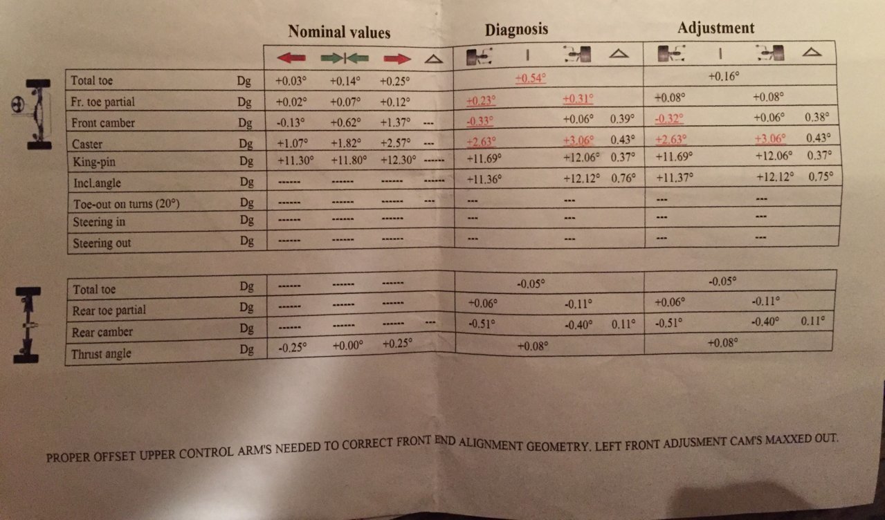

    Currently running 255’s with zero rub but thinking of giving 285’s another go.
    By just looking at these numbers could anyone tell if it’s possible to add some caster and bring the wheel towards center a bit? I did a small cmc. Last time i had 285s on 8.5” wheels and they were a little wide but not rubbing bad. Plan on 8” wheels.
    If you read the bottom it’s telling me i need proper offset control arms but i have TC ucas which really pulled tires to backside of fenders. Drivers maxed out lowered a little since but cant find that readout but it was pretty similar. Really a modest 2.5ish” lift.
