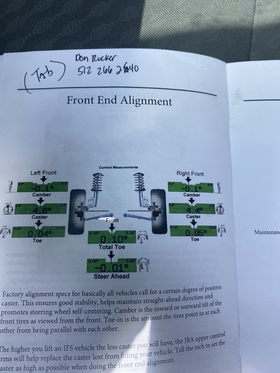

    Just curious on thoughts. I’ve been having some what I think are alignment issues with my 21 SR5. 3” lift, 285/70/17. Do you think it’s best to put alignment by to spec and do a CMC mod or just move caster highest it will go forward? When I got my new JBA UCA’s there’s an alignment sheet in the book and my last alignment guy said he set to those specs but still seems to be doing the same thing it has been since the lift. Any thoughts are much appreciated. I’ve tried uploading video but won’t upload.

    What's it doing and what are your alignment numbers?

    That alignment looks about as good as you can hope to get.
    High caster definitely feels a lot different in the steering wheel, I would drive it for a bit and see if you get used to it.

    I personally did not like that high of caster on my own truck. I know exactly what you are talking about. Lowered mine down to around 3.3

    Just got mine set to +3 caster , 0 camber and 0 toe. Feels different. Going on a road trip tomorrow. Will see how it does.

    Mine felt twitchy at 4.5. After hitting a bump I had slight osalation of the steering wheel. Plus the steering felt heavy to turn

    No cmc. I have Spc uppers. Lower eccentrics are maxed to push wheel all the way forward. I have slight rub on the plastic splash shield. Feels better on smaller bumps now.

    Splitbolt- Yes small rocks and small holes in the dirt drive, method 301 17x9 -12
    Mac- I do have JBA uppers

    I suspected a negative number...
    It creates more leverage when you move the offset that way...
    Are those your numbers or are they from the JBA instructions? Betting you have toe around 0; should be at least +0.07 for that amount of added positive scrub.
