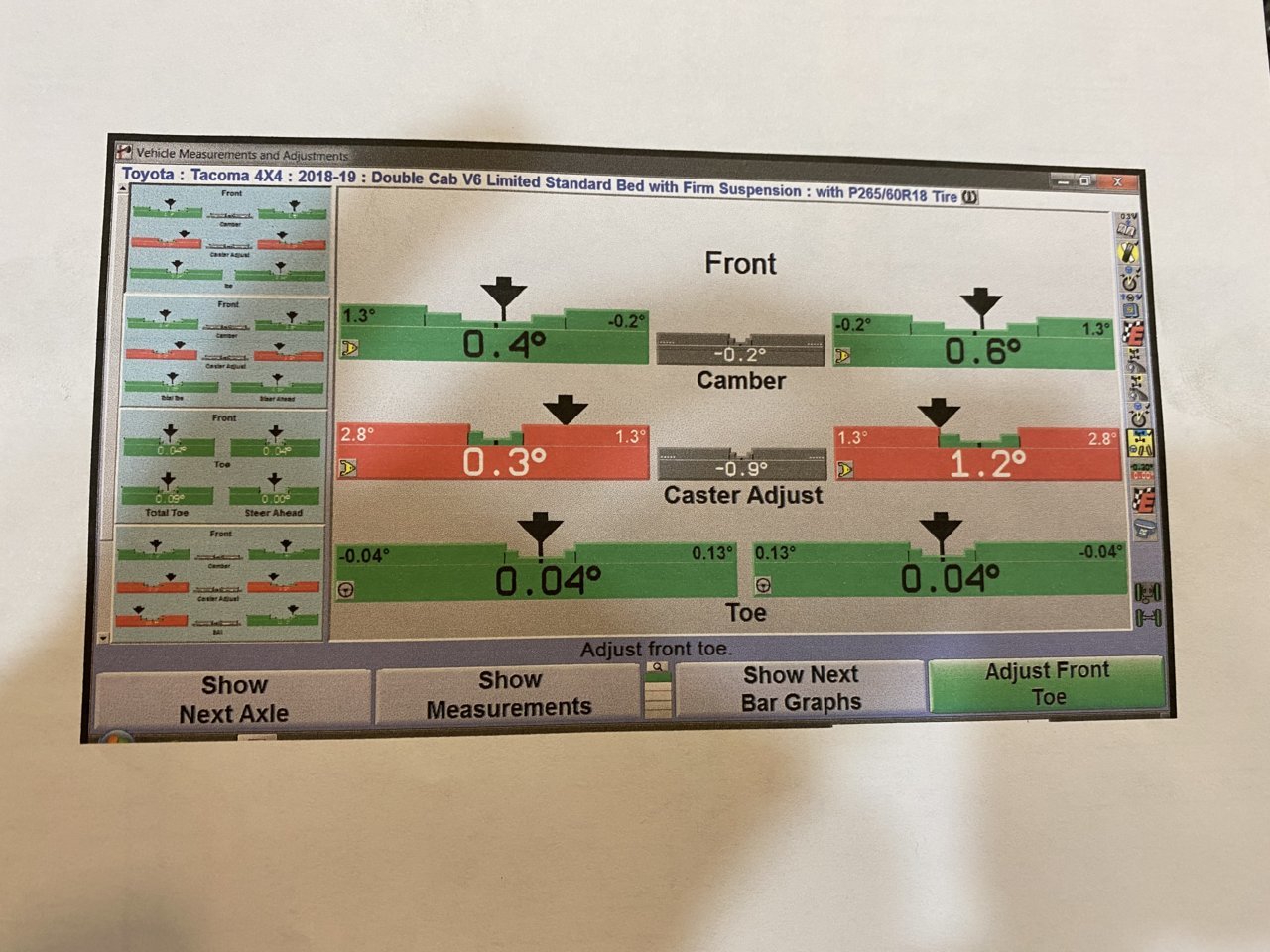

  16. Jan 21, 2020 at 8:01 AM
    #16
    hcenteno21
    hcenteno21 Well-Known Member
    May 30, 2018
    #254943
    180
    Tito
    El Paso, TX
    2020 AG Tacoma TRD Pro Supercharged
    Not trying to hijack, but also didn't feel like starting a new thread since there are so many alignment threads!
    Long story short I have a 2020 pro and I put a 1.5" spacer, stock UCAs. I have 285/70r17s on 17x8.5s. I took it to firestone and truck seems a little off it also pulls to left. Are these settings correct? Weirdly they said bring it back in two weeks after it settles, I have never been told that on my previous trucks.
    If I understand people correctly I should tell them to set caster to 2.5?
  17. Jan 21, 2020 at 8:06 AM
    #17
    su.b.rat
    su.b.rat broken truck
    Jul 30, 2016
    #193316
    9,869
    don't recommend stock UCA's on anything over 31" tire. but that's just me, because my value for caster is not merely for fitment. caster changes how it drives.
    that alignment is not great. if you want this done right you should be 3-4deg caster. they have a "caster split" there either for road crowning or simply because they guy doesn't know how to align the thing. that road crown caster split thing is bullshit IMO and you don't need compensation, you just need it straight and drive it as it goes. the camber should also be closer to 0, or properly 0 actually if you want it dialed it.
    these things do "settle" on new lift installs, but unlikely the numbers will change.
  18. Jan 21, 2020 at 8:11 AM
    #18
    hcenteno21
    May 30, 2018
    #254943
    180
    Tito
    El Paso, TX
    Gotcha, I wasn't sure I needed UCAs since I only used a 1.5" spacer. Did not know I needed UCA bc of tire size! Newb here lol. Do I get a specific UCA? I have seen some that are for 3" lift per say. Thanks a ton
