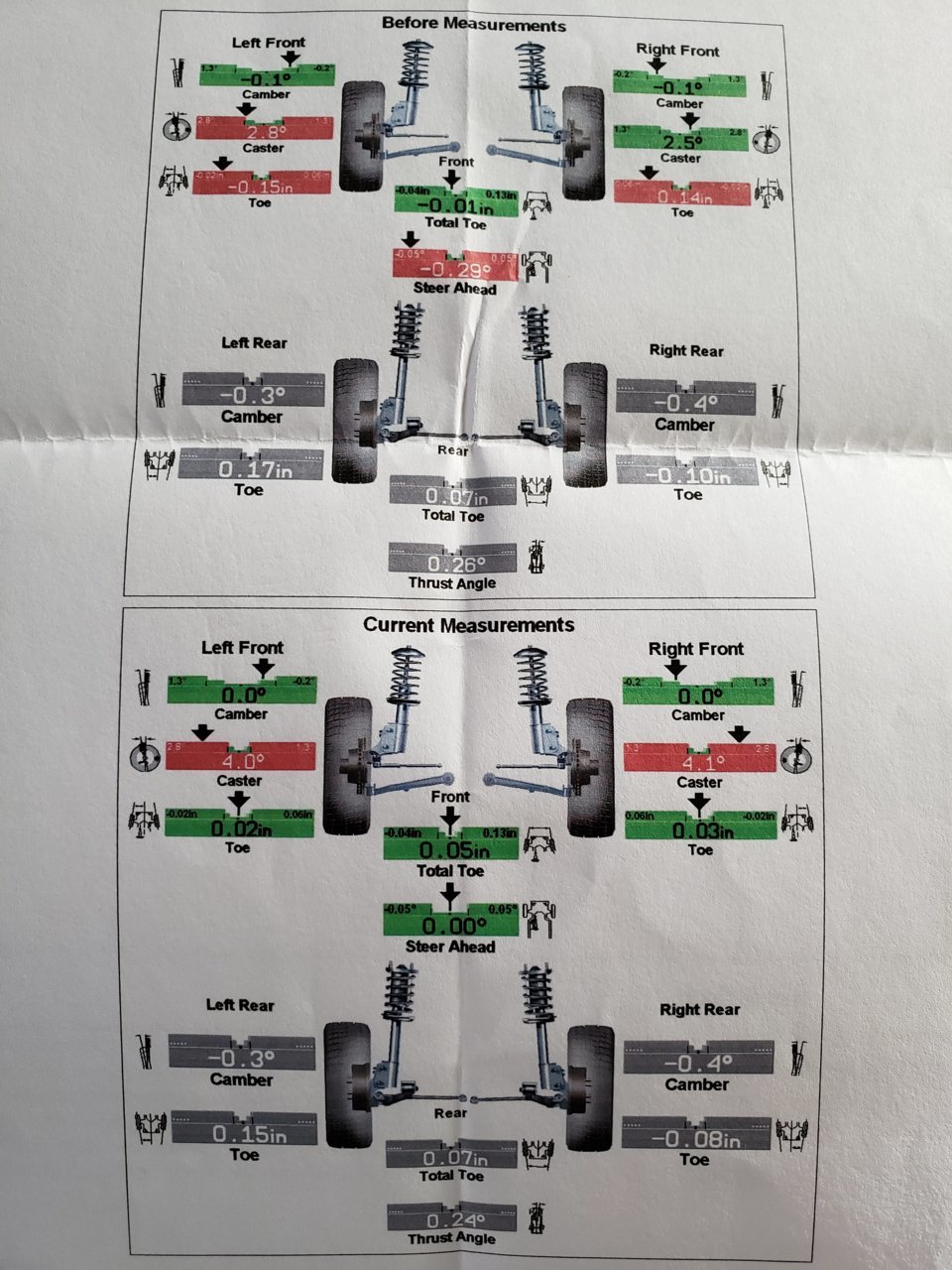

    Thoughts on my alignment I just got done. 2” lift on Icon Coilovers with tubular delta joint UCAs
  19. Aug 18, 2021 at 11:01 AM
    #59
    truckbeans
    truckbeans Well-Known Member
    Mar 18, 2019
    #287058
    242
    Kent
    Sylva, NC
    2018 DCSB OR
    OME 887s, nitrochargers all around, Headstrong progressive add-a-leaf, 255/85-R16 Yokohama Geolandar M/T, Full set RCI skids, RCI sliders, SOS Slimline w/ Smitty 10k winch
    I don't know how much caster is built into the UCAs, but if your tire setup is clearing then those numbers look good!
  20. Aug 18, 2021 at 11:53 AM
    #60
    Gmak621
    Gmak621 Łøādîñg…
    Dec 13, 2020
    #349537
    1,579
    Nørth Çøast
    2024 TRD ØR
    I am not sure either exactly how much is built in either.
    But my tires don’t rub. And they didn’t rub before the lift either
